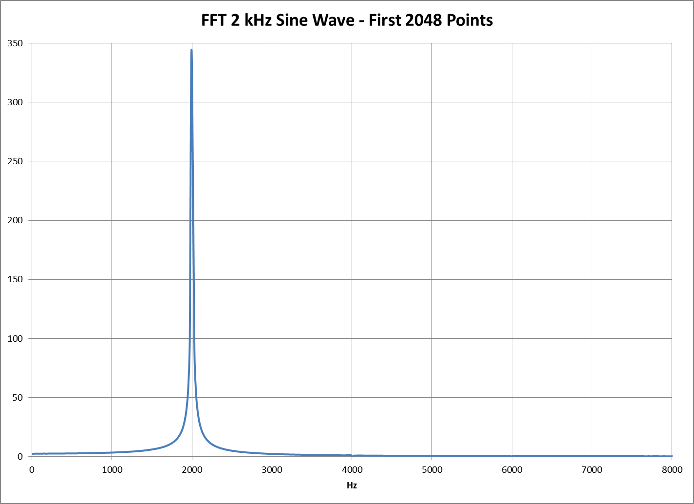

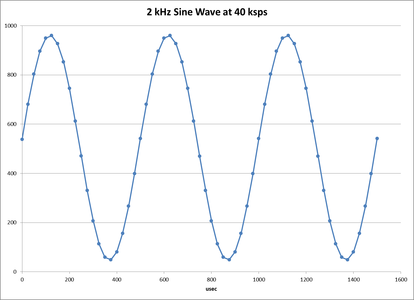

The attached file, DATA.png, is a plot of a 2 kHz sine wave logged at 40,000 samples per second. FFT.png shows a FFT of this data.
