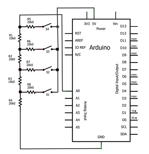

I’m trying to read wich button is pressed (of five) with an analog input… here’s the circuit I’m using:
but I’m using 5 buttons and only 1k? resistors (instead of 1 and 2 k?, like in the image)
and here’s the code:

but what the only thing I get is:
“Button 0 pressed”
:frowning:

You mean "if (b==0)", not "if (b=0)". As it's written it sets 'b' to zero which is always false so it prints "Button 0 pressed".
ehehe I'm sorry for being so weird... thank you very much! :D
FYI:
That circuit as shown forms what is known as an "R/2R" ladder - a basic DAC circuit. It relies on the ratio between 1 resistance and double it's resistance (10K? / 20K?) to give good stable results and the ability to detect multiple concurrent button presses.
Using resistors of all the same value (the actual value is irrelevant) will not give such good results as multiple concurrent button presses will give skewed values.

@majenko
I don't need to detect more than one button at the same time, but thank you very much for the explanation (anyway I have to buy 2k? resistors, I'm just starting)

There is a world of difference between shouldn't happen and won't happen. The resistors you are using. What tolerance are they? Generally, they are +/- 10% of the rated resistance. A 2k ohm resistor can measure anything between 1800 and 2200. That WILL affect the output from analogRead when a given voltage is applied.
I don't understand the "it doesn't matter" part. A reading of 505 doesn't correspond to no switch pushed. It means that some switch was pushed. The key is determining which one.
It is 5% rated. Anyway you're right... I'm going to correct the code as you told me, I think it's a better solution :) thank you
