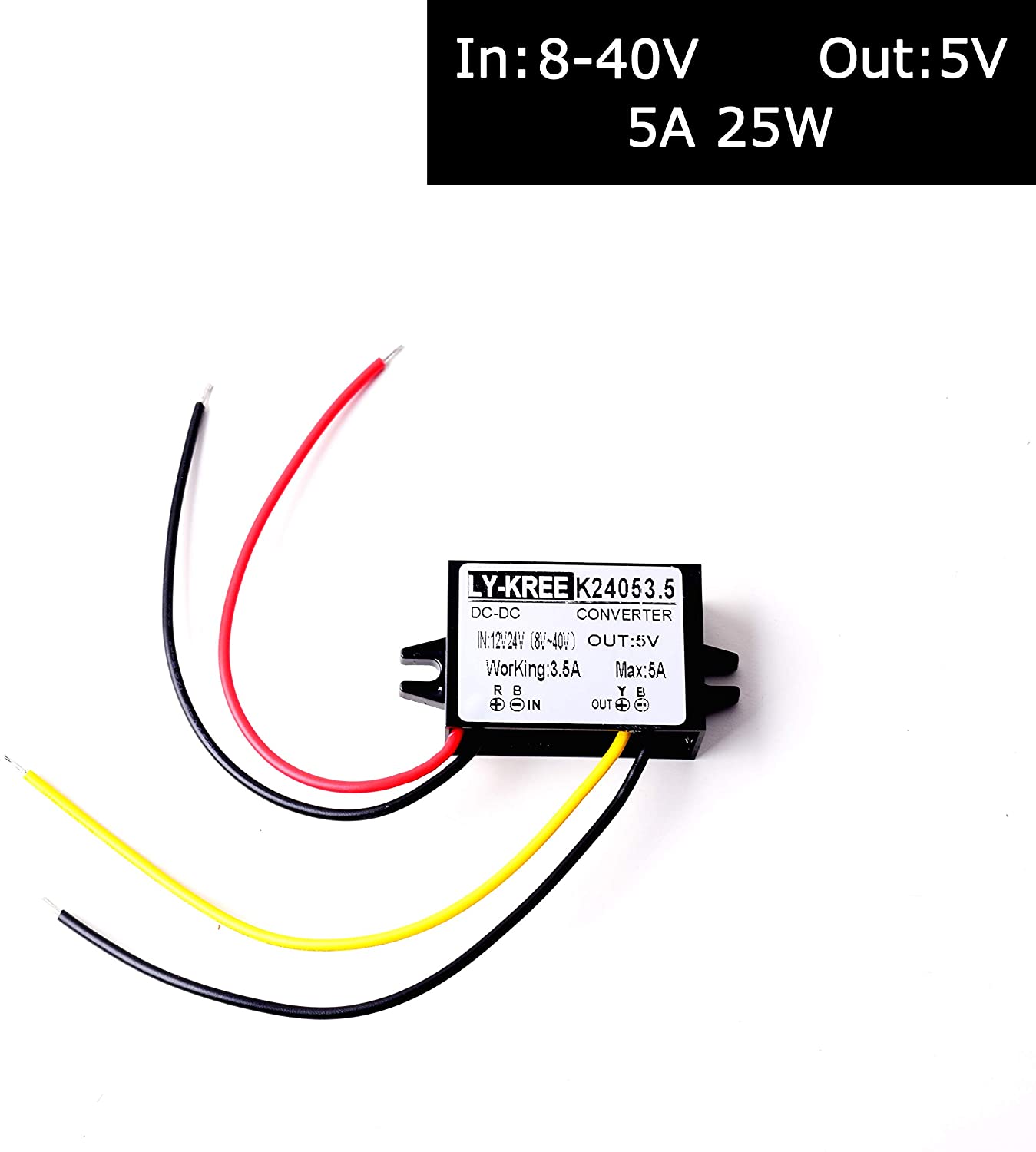

The UPS for my Raspberry Pi uses a 12V LiFoPo4 6Ah battery.
I use a LiFePo4 charger like this one,
The charger connects to the LiFePo4. The LiFePo4 is connected to a 5V regulator, like this one:
The regulator, which has output filter caps, is what powers the RPi.
I've ran the RPi for 8 hours on battery.
I use this battery:
I use this case to hold the battery:

The setup I explained above, the RPi is always running off the battery.
The Charger, feels the battery volts. If the battery is at, in this case, 13.8V or more, the charger shuts off charging mode. When charging mode is shut off the RPi is being supplied by the battery. As the charge on the battery drops, the charger, at a set point, starts charging the battery again. This cycle continues.
All those components came from Amazon.
It is not disruptive to move from main power to battery.

Regulator:
AmazonSmile: DC 12v 24v to 5v Step Down Converter Regulator 5A 25W Power Adapter Reducer for Car Electronics Truck Vehicle Boat Solar System (Accept DC 8-40V Inputs) : Electronics
