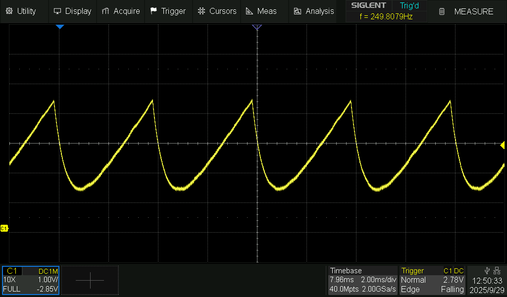

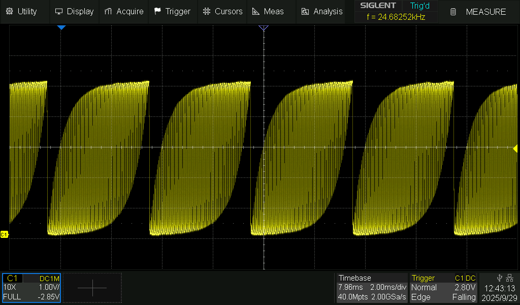

The author of the code suggests using 470Ω and 10nF.
I think that his recommendation is off in the other direction.
Here is an oscilloscope trace showing a 1kHz sawtooth using his values:
Hardly looks like a sawtooth to me.
The waveform can be improved by using a higher value resistor and/or capacitor.

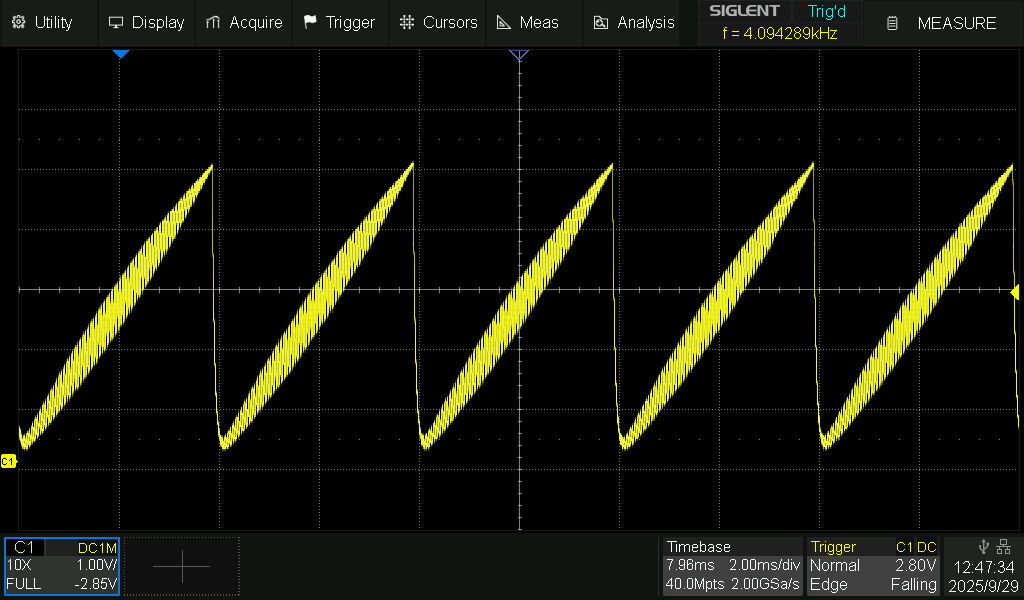

Here is the same 1kHz sawtooth using 4.7kΩ and 10nF:
That looks better, but could be improved still.
Here is the 1kHz sawtooth with 47kΩ and 10nF:
The low pass filter has now degraded the falling edge of the waveform and reduced its amplitude, due to the cutoff frequency being too low.
So you can see that there is probably an optimum value of component values somewhere between the second and third values used.
However this only applies for one particular output frequency.
If you want to generate a range of frequencies, then you will have to accept some compromise.

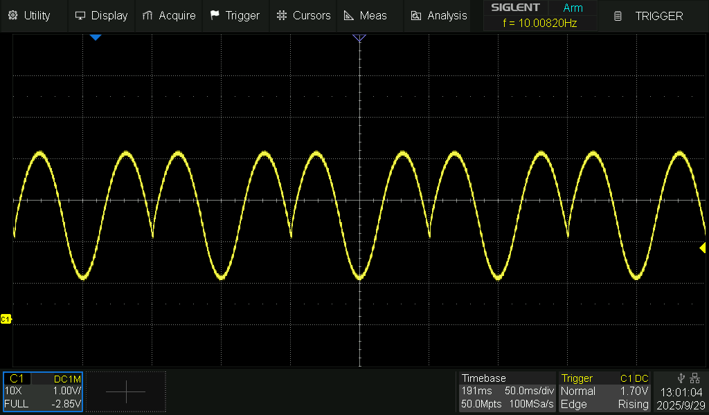

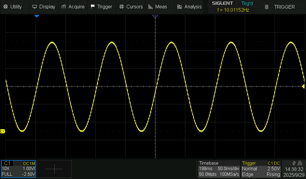

The code that you are using does not generate sine waves correctly.
This is what a 10Hz sine wave looks like:
The code generates 1.5 cycles of the sinewave in 10ms, instead of 1.
It is due to errors in the sine wave look up table.
I will see if I can correct it.

I've done it already.
I just fixed the look up table to go though one cycle instead of 1.5 cycles.
