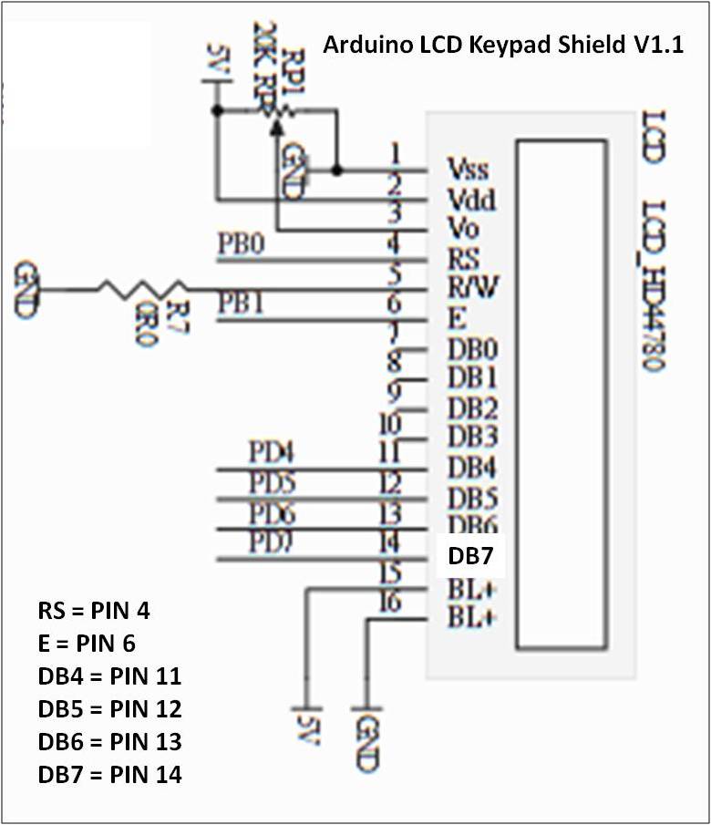

Hello Erdin,
It says "Deek-Robot LCD Keypad Shield" on the back of the Lcd. I purchased it on ebay http://www.ebay.com/itm/320986648816?ssPageName=STRK:MEWNX:IT&_trksid=p3984.m1497.l2648
I am using the "arduino Mega 2560 or mega ADK" board.
RS = Pin 4
E = Pin 6
DB4 = Pin 11
DB5 = Pin 12
DB6 = Pin 13
DB7 = Pin 14
As you can see from the picture of the Lcd Shield pinout, I made a mistake - it should be pin 4 and not pin 5 as I posted in my first post. Thanks for the links - there are lots of Lcd code examples there.
Thanks Again
jessey
Thank you for the photos. I think "Deek Robot" is a clone of "DFRobot".
The "PIN 11" and so in the drawing is the pin number of the LCD shield. Not the Arduino pin number !
According to that drawing:
DB4 = Arduino pin 4
DB5 = Arduino pin 5
DB6 = Arduino pin 6
DB7 = Arduino pin 7 (although I read this one clearly)
And if I look at the photo of the back side, and follow the copper traces, I think that are the pins.
I can't figure out 'E' and 'RS'. They could be connected to Arduino pin 0 and 1 but also to 8 or 9, or 10, or 11.
Do you have a multimeter ? Can you measure to which Arduino pins the 'E' and 'RS' of the LCD are connected ?
You could try RS = 8 and E = 9. Did you try the example in the previous post ?
LiquidCrystal lcd(8, 9, 4, 5, 6, 7);
With the example running you have to adjust the variable resistor, until the characters become visible.

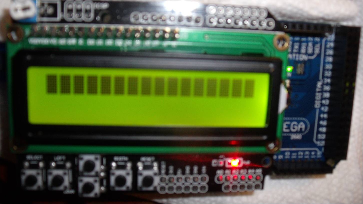

Hello Erdin & Jimbo,
No success yet but I haven't given up. I did as you suggested Erdin and used my multimeter to determine the pin numbers which I have in the code below. The code below compiles but only shows the the top line with black boxes as the attached picture shows. I did try adjusting the variable resistor but no cigar. I must be missing something in the code. I also tried running the code you sent me to try and I also changed the pin numbers and got the same results. I will keep plugging away trying to figure out what's wrong and in the meantime if you or anyone else can think of something else to try, it will be much appreciated.
Thanks
jessey
#include <LiquidCrystal.h>
LiquidCrystal lcd(10, 9, 7, 6, 5, 4);
// define some values used by the panel and buttons

Erdin's suggestion, as well as the DFrobot site code which I use successfully (with a genuine DFR0009) is:
You have this...
You sure of the "10"?... did you try "8" there in the first position?
Your right Jimbo,
I'll try it again with his pin numbers and get right back to you...
Thanks
jessey
Just find the same LCD in my "do-later" box, and get same picture like yours - only upper line lights up.
http://www.robotshop.com/ca/cytron-lcd-keypad-shield-arduino.html
I find out right pin numbering, now it works with both library, LCD4bit_mod and default arduino LiquidCrystal.
//LiquidCrystal lcd(12, 11, 5, 4, 3, 2);
LiquidCrystal lcd( 8, 9, 4, 5, 6, 7);
RS, E, D4, D5, D6, D7 correct sequence. Tested with "customCharacter" example.
I'm using UNO.
