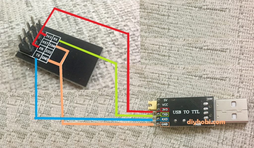

I have try to connect it directtly to the USB-Serial
Flash ESP-01 using USB to TTL CH340G Converter Module Adapter
did the same connection
GND - GND,IOO
VCC (3.3V) - VCC,En
Rx - Tx
Tx-Rx

Are you connecting the USB adapter to the ESP with jumper wires? Sometimes bad quality jumper wires can do that. A lot of my jumper wires give me that error. I eventually ended up making a pcb for programming ESPs. Maybe try with other wires.

You will get this error if you selected the wrong com port in the IDE tools.
You can also get this error if you do not pull IO0 down BEFORE applying power to the ESP.
Optional: After you apply power to the ESP, you can remove the ground from IO0. Or not. After the ESP boots into the flash mode, it will stay in the flash mode regardless of the level of IO0.

I have change the wires - still nothing
took anotherESP-01 , also didn't work

Yes but it is not your fault, it is an error in the tutorial.
it should be
GND - GND
GND - IOO
VCC (3.3V) - VCC
VCC (3.3V) - CP_PD (En)
VCC (3.3V) - RST   (This connection is missing !!!)
Rx - Tx
Tx-Rx
So the pin between VCC and EN also needs to be connected to 3.3V+ and then it should work. Just to be sure can you post a picture of the ESP-01 you have ?
