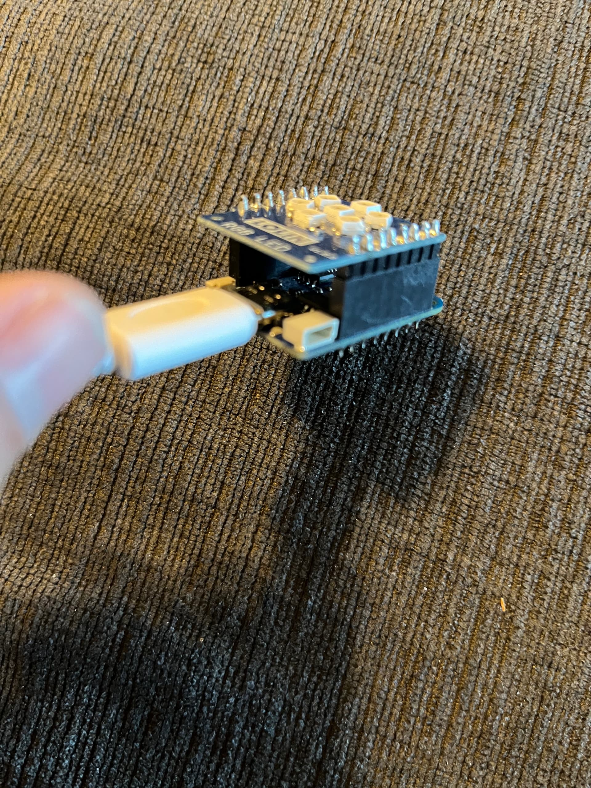

This is how I have it built
That is how I imagined it from your description. What I was suggesting was to use sockets on the D1 Mini with longer pins that would protrude below it an plug into a power management board of the same size, thus retaining the all in one nature of it
Are you really using USB C as I did not think that was what the D1 Mini used. What is the white "blob" to the bottom right of the picture ?
Correct! The D1 mini v4.0 uses usb c. The little white blob is a spot to plug in a lithium battery I believe.
My soldering job on this module is not great, which is why I haven’t given it to anyone and just use it to test codes
