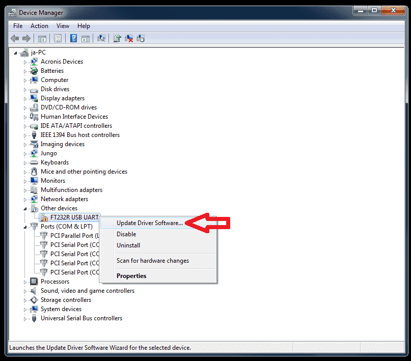

Then open Device Manager and connect the USB to TTL converter to the system. If the system does not recognize the converter, a warning sign will appear next to the converter name, as shown in the image. Right-click on it and click Update driver.

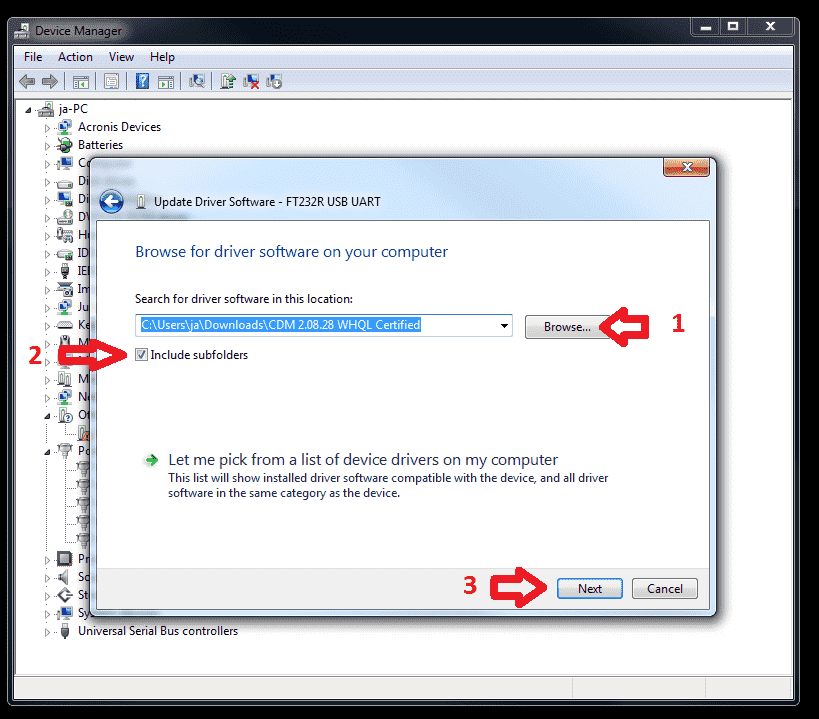

At this stage, first click on Browse my computer for drivers, then go to the path of the driver you downloaded as shown in the image below. If your system is 64-bit, enter the x64 path address. If your system is 32-bit, enter the x86 address and click Next.
At this point, wait for the driver to be installed.
And in the last step, after installing the driver, click Close.

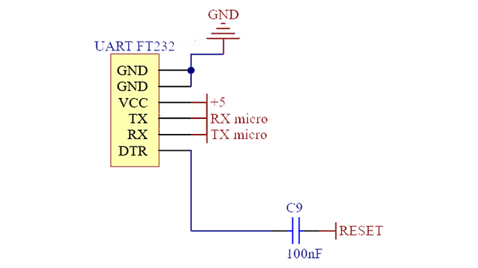

You can use this module to start up micros and modules that have TTL communication. Connect the FT232 module to the desired micro and module according to the schematic below and then you can use it.
According to the picture, TX is converted to RX of the micro, RX is converted to TX of the micro, and the DTR pin is connected to the RESET pin of the micro with a 100nF capacitor. Then you can do whatever you want.

Checking the connections between the FT232RL and the microcontroller
The "not in sync" and "programmer is not responding" errors occur when the microcontroller and programmer (such as the FT232RL) cannot communicate properly.
1: Make sure you have done the wiring correctly.
2: Important: The RESET pin must be connected to DTR via a 100nF capacitor. Otherwise, communication will not be established.
