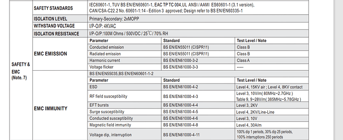

This is hard JohnRob. Thanks for your great comments and explanations. I actually bought Power supply that has 60601-4-4 feature. In its datasheet it says this power supply complient with 60601-4-4 too. I get confused after these mentions.

I have the right to try. If it is as you mentioned, we need to change the design. But I'm thinking of putting an aluminum shield to see if that's the problem. If the problem is solved with it, I will follow a path accordingly.
