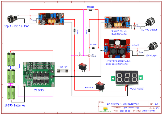

Post a schematic of how you see this connecting together. It doesn't have to be perfect, just legible. Give us something to work with. Identify the components you already have on-hand. Don't buy anything else until we sort this out.

The instructable you provided is what I had in mind, using a 4S rather than a 3S. Plus the 50W and 100W 4S I pointed to has an internal BMS provided.
I have tried connecting two of those packs directly to the load ... disaster ... I need something in between... best if switching
Did you diode isolate them? place schottky diodes on the positive outputs

SB10150 will work
Might be good if you posted a diagram of how you connected your packs to load.
A copy of your circuit, a picture of a hand drawn circuit in jpg, png?

I don't have an exact idea, the nearest thing to a schematic is what I found in the instructable
I will use the battery packs internal bms as bms, since those packs already come with a bms.

OK, maybe I shouldn't have used the term schematic. On a piece of paper, draw a diagram of the components you have and how you THINK they should be connected together. The components can be simple squares or rectangles. Identify the connections as its voltage. Draw a line from connection to connection showing how you envision it should be connected. Show how the solar panel connects. Are you using one or two panels? Take a picture of this drawing and post it.
It doesn't have to be pretty, or accurate. Just show us on paper what you have and how you think is should be connected. Does your wifi need 12V or 5V?

The 1N5822 in your schematic would be a better fit as long as you stay under 3A. It was right there in front of you the whole time.
Sorry I just wanted to be sure about the diodes too sure and the magic smoke comes out
With the parallel diode set-up it will just flip-flop back and forth between the two batteries until both are dead.

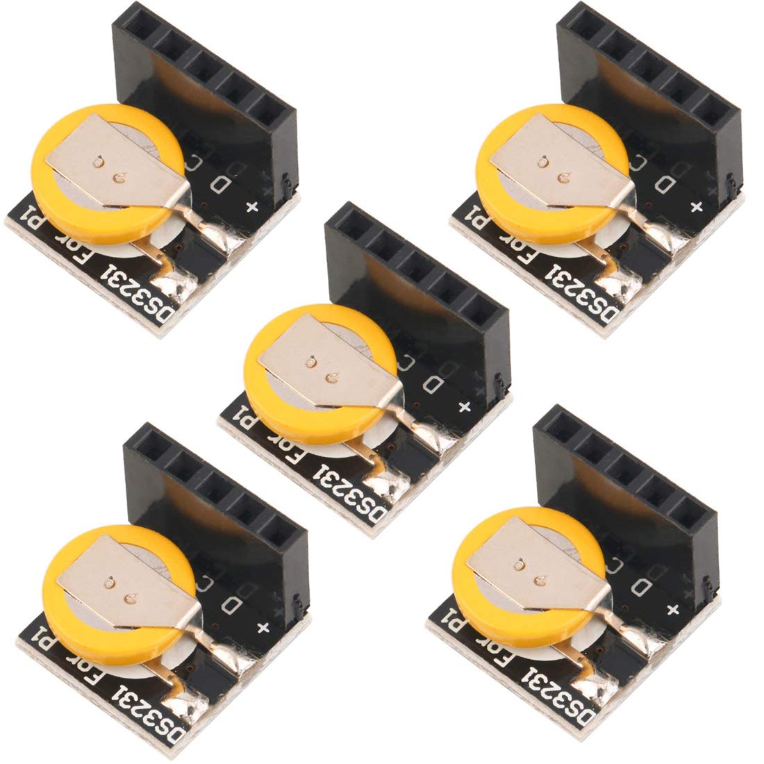

the more I discuss this here the more I like the idea to time the power consumption and switch one minute before the battery is empty
for now I haven't bought anything in regards the switch pcb. I like your idea of timing the power consumption with the contraption under stress (simulating a worse case scenario where the device is sucking up electricity like there's no tomorrow) and I would use the internal arduino uno hardware clock, or something like this
