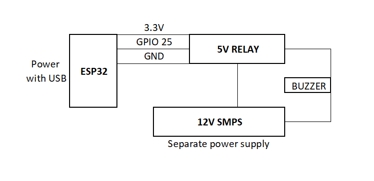

hello experts,
I am working on a task
It includes ESP32, Max485, P10 displays, Buzzer (relay).
The Esp32 is powered through 5v 2amp adapter and ferrite bead as well as 103,104 caps are used before Vin pin.
The 5v relay module is powered directly by same adapter, but the trace is connected to Esp32 Vin pin.
I am using a power supply of 12v 5amp to Buzzer, which is triggering through 5v relay, controlled by Esp32 gpio32.
My issue is, when my relay is triggering the 12v buzzer, Esp32 started malfunctioning for a moment.
But, it is not happening on every trigger, it randomly occures and all cycle disturbes
I can not understanding, what is happening and why
My thinking is,
It may be voltage spikes
Need to use flyback diode in parallel
Need to use ferrite bead and 103, 104 caps near relay power supply
Please help me
TIA
Please post a wiring diagram (hand drawn is preferred) with all pins, connections and parts clearly labeled. A photo of your setup would help, too.

Itis very simple drawing
5v to 12v cable is 1 mtr in length
12v to Buzzer is 10" in length
Apart from buzzer, there are many other duties performed by Esp32 e.g.TM1637, 4 buttons, Max485 etc.
Back fire current interfering in these all functions and Esp32 cycle get destroyed in total

What is in the square labeled "5V RELAY"? Please post a link to the product page, and other relevant details.
A photo of the setup would help.
5v 1 channel relay module
Its without optocoupler
I think, i need to use flyback diode near 12v rail
Previously I used that circuit for 22v LED flashing, No issue
Mofset or transistor can be used
For 12v 5amp item, what Ic will you suggest
or I need to use 5v relay module with optocoupler ?
Depends on what it is. Post a link to its technical info. Generally a solid state relay will work best.
