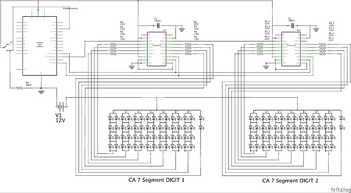

-2 7-SEGMENT RED 6.5" DISPLAY( common anode, 12v)
-1 MICROSWITCH (2 way, NC/NO datasheet attached).

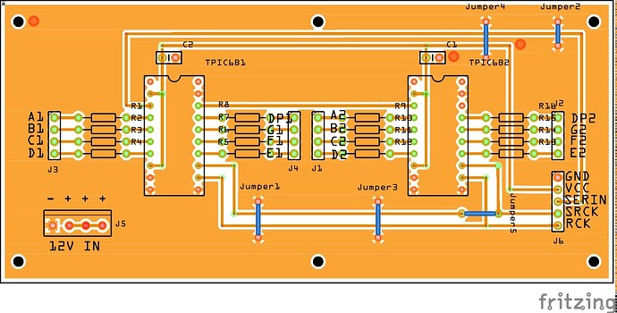

I'we already made the PCB and soldered everything...made all connections and tried to write a code but with no result, my knowledge in programing is low...

This is the principle of operation:
-start from 0
-count 1 every time the switch is touch
-continue for 1 minute
-show the final score
-push reset button to start over.
I attached the circuit scheme.
Thank you for your attention!
I attach also the pcb layout...maybe i did something wrong here...it's 1 layer pcb.
Thank you!
