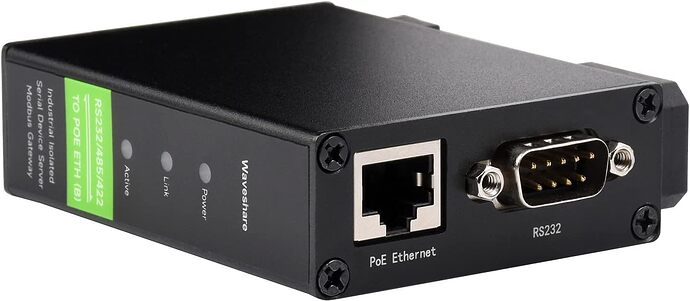

If that is not working and even it looks over-engineered, I think such a module could be the smart way:
What do you think?
Felix
