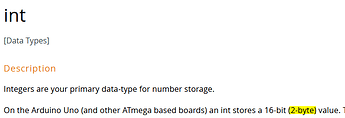

Just fyi, before I start thinking about the logic, that's not doing exactly what you think it is.
sizeof(pumpPins) is not the number of elements of the array, it's the size of the array in memory. So to get the number of elements, you need to divide that by the size of an element, sizeof(pumpPins) / sizeof(pumpPins[0]).
Some test code:
int myArray[] = {2, 3};
  Serial.print("Size of the array in bytes: ");
  Serial.println(sizeof(myArray));
  Serial.print("Size of each element in bytes: ");
  Serial.println(sizeof(myArray[0]));
  Serial.print("Size of array / size of element = number of elements: ");
  Serial.println(sizeof(myArray) / sizeof(myArray[0]));
void loop() {}
Output:
As the manual says,an integer is 2:
Hello retcon
