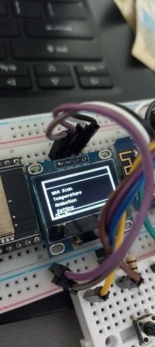

U8g2 display menu scoll
Hey guys, im find problem with oled menu scroll with library u8g2. i will show scroll menu, i make 5 menu but cant show all of menu, can anyone help me please
#include <U8g2lib.h>
#include "DHT.h"
#include <ESP8266WiFi.h>
#define btnup   D3
#define btndown D4
#define btnok   D5
#define btnback D6
#define DHTTYPE DHT11
#define DHTPIN  D7
U8G2_SSD1306_128X64_NONAME_F_HW_I2C u8g2(U8G2_R0, /* reset=*/ U8X8_PIN_NONE);
int maxmenu       = 5  ;
int selected      = 0  ;
int entered       = 0  ;
int page          = 0  ;
int stats         = 0  ;
int contrast      = 50 ;
int optionSpacing = 10 ;
int frame         = 0  ;
bool scanning     = false;
int progress;
DHT dht(DHTPIN, DHTTYPE);

wokwi simulator
Screenshot 2024-03-27 110338
wokwi link
Your bitmaps are 128x72 while your screen is 128x64.
