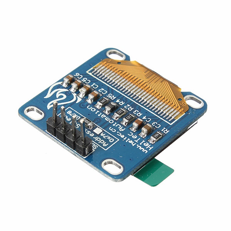

Hi Oliver
That one works whit this oled http://i.ebayimg.com/00/s/ODAwWDgwMA==/z/GiQAAOSwnDZT-sxO/$_57.JPG
But when i am trying to run that exactly same cod white this screen https://www.adafruit.com/images/1200x900/326-18.jpg
Both are using I2C and are 128x64. The both works but i cant only use the other one on adafruits library and the second on whit U8glib.
I'cant figured out what the difference is why i can't just change the both screens from the two breadboards.
I'am only running the test graphs test whit the two librarys.
Live long!
The Adafruit OLED requires a different init sequence. Did you try the u8glib adafruit constructor for the SSD1306? It is mentioned here:
Oliver
