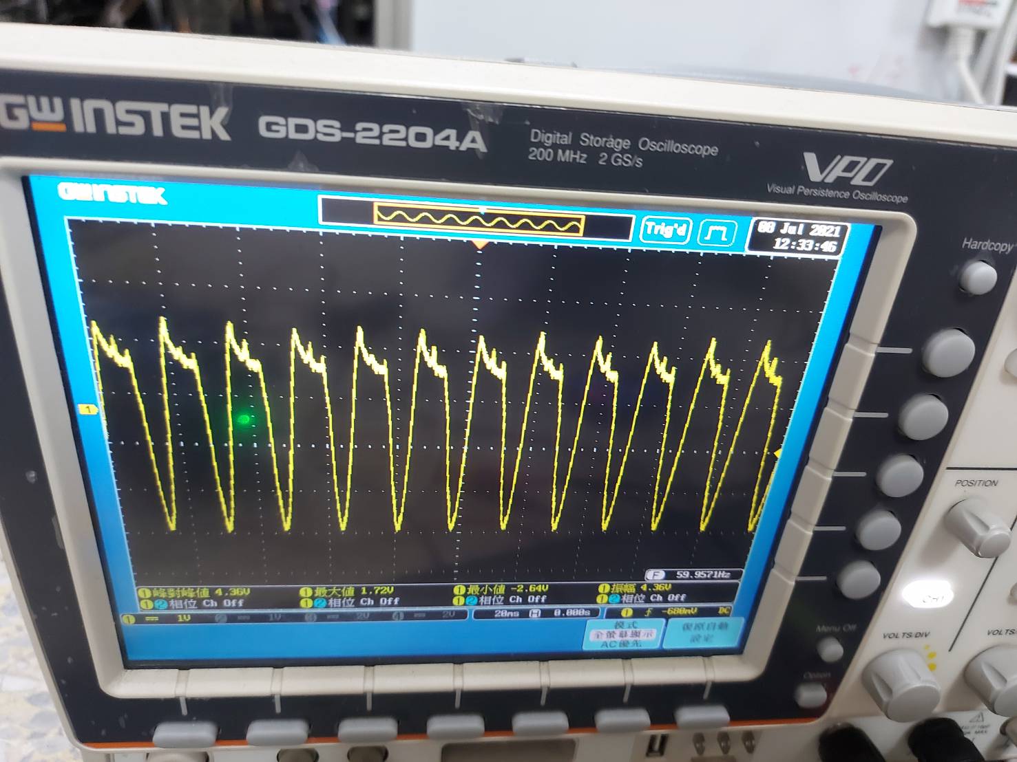

I measured the waveform from TTL, which is between RS232 and Arduino.
This is what it looks like...
Kinda weird...
When it says "no data!" it means that one or more of those comparisons failed. Perhaps you should print out the value of the 9 bytes in buffer before you look for the pattern.

tony_lai:
Kinda weird...
time to show a wiring diagram and indicate where you measured
A power supply with 48V drives the motor control circuit, and a converter reduced the voltage to 5~15V for PIC.
PIC is connected to laptop through ICD3.
The Arduino is power by the same laptop.
48V---->converter---->5V---->PIC--->MAX232---RS232---MAX232--->TTL------------->Arduino----->laptop
|-------------------------------ICD3--------------------------------------->|
About the common ground, the circuit I'm using in PIC is Figure 1, the RS232 wiring is Figure 2, and the MAX232 to TTL is Figure 3.
The place I've measured is at Figure 3, where the circle is.
I think that that is what you have to sort out; doesn't look like a TTL signal to me.
What do the PIC signals look like? What do the RS232 signals look like?
The Tx signal from PIC is:
The signal from Max232 is:
The signal from TTL is:

tony_lai:
presumably the RX of the mega is connected to the TTL out of the max232 and same for TX
it is the RX and TX connections between the max232s, between the DB9 connectors, either in the cable or that short connector with the orange band, that are swapped
tony_lai:
Figure31107×1477 174 KB
dlloyd
July 10, 2021, 2:47pm
16
I agree ... looks like you have a null modem adapter where possibly the data and the handshake lines are crossed.
