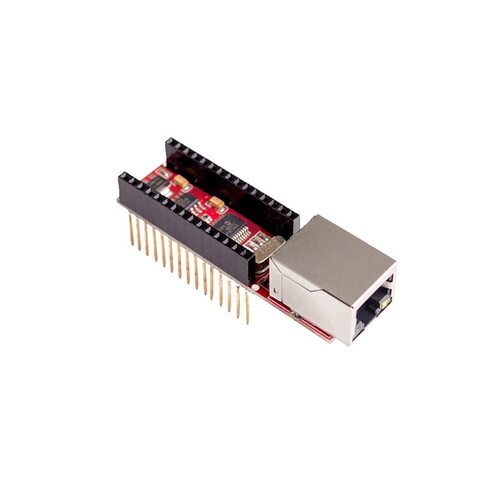

I've bought an Arduino nano Ethernet Shield (see below) and i'm trying to send some UDP packets to it.
I've used both EtherCard and UIPEthernet libraries but for UDP i can't see any messages on it.
I know it's working because, using EtherCard "backSoon" example i can connect to the ip assign and see the "hello world" page.
I tried using the examples of both Ethercard and UIPEthernet for UDP server and from my laptop, using Packet Sender i trying sending some messages but nothing happened.

and i get the output:
ENC28J60::init INFO: Chip erevid=6 initialization completed.
initialize: success
192.168.1.46
can someone help me identify what i'm doing wrong and why in "webserver" mode the shield is workign and for UDP it isn't?

My problem was with my laptop. I guess the firewall or something with the packet sender software. I send some udp messages from my phone (using tcp udp client app on iphone) and it worked great.
