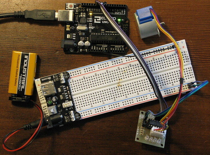

I am trying a simple stepper motor example using the ULN2003 with a 28BYJ-48 steeper motor. I have set the speed to very slow so that when i connect the ULN2003 without the motor I can see the LEDs flashing in their correct order: CD, BC, AB, DA. However when I plug the motor in the LEDs all turn off and the motor does nothing. I have tried four different motors and four different ULN2003 boards. What am I doing wrong?

Using a 9V battery.

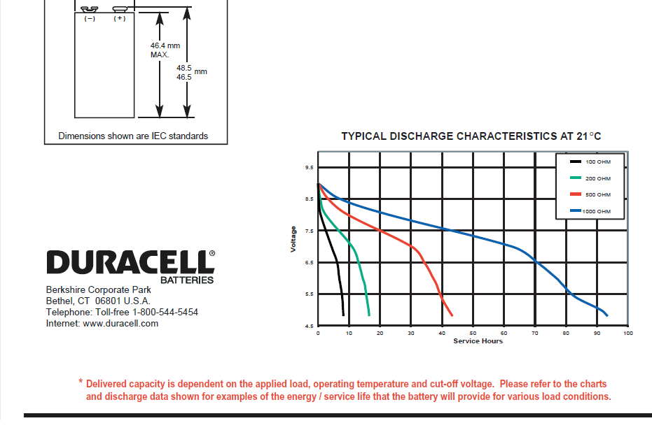

Look at the figure below which is the battery voltage per elapsed time as a function of the drained current.

These batteries do not supply enough current that the motor needs.
Use an external 9V source.

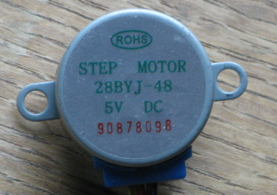

Thanks for the useful response. However the motor is a 5v motor, I'll see if I can find an external power supply but the battery was a fresh one, so i'm still puzzled.

If you remove the battery you can plug in a usb 5V adaptor into the USB port. That should power the motor
Jim
Thanks. That fixed it.

in this datasheet it is 5V.
https://www.mouser.com/datasheet/2/758/stepd-01-data-sheet-1143075.pdf
Oh my goodness, you can't even trust datasheets anymore lol
