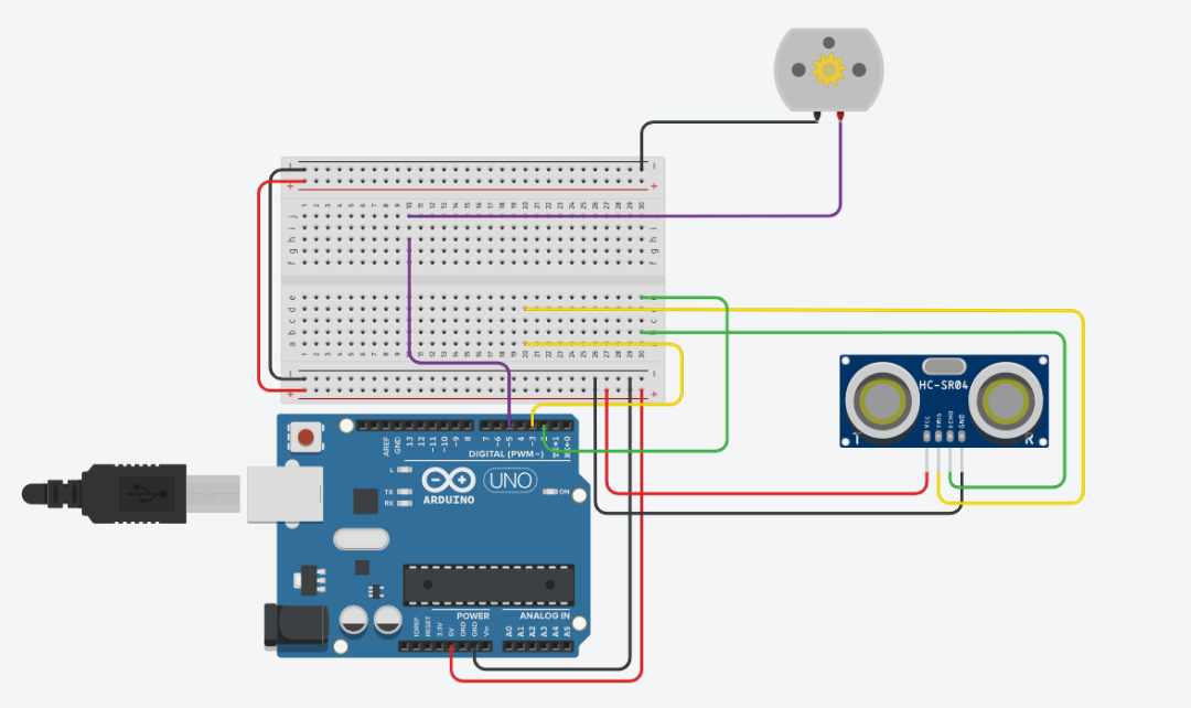

Hi guys, I am new to this.
when i made this circuit, it is not working. I put object infront of the ultrasonic sensor and the dc motor is not working. this is the code:
// C++ code
int distance = 0;
int motorPin = 5;  // Assuming the motor is connected to digital pin 5
unsigned long motorActivationTime = 0;
int motorSpeed = 128;  // Set the motor speed to 128 (adjust as needed)
long readUltrasonicDistance(int triggerPin, int echoPin)
  pinMode(triggerPin, OUTPUT);  // Clear the trigger
  digitalWrite(triggerPin, LOW);
  delayMicroseconds(2);
  // Sets the trigger pin to HIGH state for 10 microseconds
  digitalWrite(triggerPin, HIGH);
  delayMicroseconds(10);
  pinMode(echoPin, INPUT);
  // Reads the echo pin, and returns the sound wave travel time in microseconds
  return pulseIn(echoPin, HIGH);
  pinMode(motorPin, OUTPUT);
  Serial.println(0.01723 * readUltrasonicDistance(3, 2));
  distance = 0.01723 * readUltrasonicDistance(3, 2);
  if (distance < 20) {
    analogWrite(motorPin, motorSpeed);  // Spin the motor at the specified speed
    // Set the motor activation time
    motorActivationTime = millis();
    // Check if 15 seconds have passed since motor activation
    if (millis() - motorActivationTime > 15000) {
      digitalWrite(motorPin, LOW);  // Turn off the motor after 15 seconds
  delay(10); // Delay a little bit to improve simulation performance

Looking at your wiring diagram I would not expect it to work. You need to power the motor with an external power supply. By connecting the motor to the Arduino you could have possibly damaged the Arduino. Here are some simple rules to follow:
Gil's Crispy Critter Rules, they apply to processor hardware:
Rule #1. A Power Supply the Arduino is NOT!
Rule #2. Never Connect Anything Inductive to an Arduino!
Rule #3 Don't connecting or disconnecting wires with power on.
Rule #4 Do not apply power to any pin unless you know what you are doing.
LaryD's Corollarys
Coro #1 when first starting out, add a 220R resistor in series with both Input and Output pins.
Coro #2 buy a DMM (Digital Multi-meter) to measure voltages, currents and resistance.
Violating these rules tends to make crispy critters out of Arduinos.
Do another schematic following the above rules.
Hi, @charmelle_09
Welcome to the forum.
Thanks for using code tags. :+1:
Have you written some code to JUST test the ultrasonic?
Have you written some code to JUST test the motor?
If not, then its a good place to start, to prove you can communicate with the hardware.
