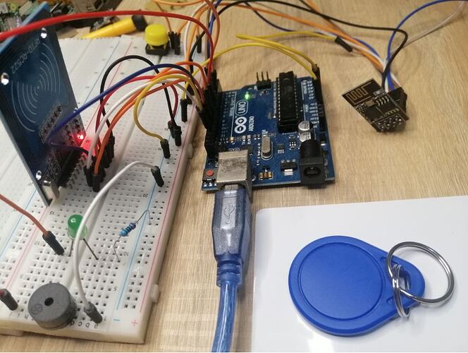

I'm trying to do a project RFID Reader door open with arduino mega and esp8266-01, in this part of my project i was able to check if my iD exists on my database, the problem is that my return from esp-01 is not appearing on my arduino console(serial), it's just say "Waiting for response from ESP-01...."
"Finished processing response from ESP-01...."
above is the site where i saw the code
my arduino code

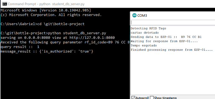

the result "i want my arduino to write on console "authorized"
The only way I can see that happening, is if the ESP does not respond in under 5 seconds
          while (!mySerial.available())
            iCtr++;
            if (iCtr >= 100)
            delay(50);
If you get no response, the above while() loop exits, but the next part is not true
          if (mySerial.available()) {
            bool isAuthorized = isUserAuthorized(tagContent);
so this never gets called. I'd suggest a couple of things
  1. put a debug statement inside your first while() so you know you timed out
            iCtr++;
            if (iCtr >= 100) {
              Serial.println("Timeout waiting for ESP-01");
            delay(50);
  1. maybe increase your timeout value if that is the issue.
I have to say that you really are making it hard for yourself using both an ESP8266 and an Arduino. The ESP should be able to do all the processing and interfacing with a MFRC522 would be easier.
The article referenced appears to completely ignore the level conversion required between the Arduino and both ESP and RFID module. :roll_eyes:
A WeMOS D1 Mini would interface directly with the RFID and perform the complete function, there are probably even ways to use just the ESP-01.
yha but my company decide to buy esp-01, i really wanted a node mcu or wemos d1 min, the esp-01 don't have many ports...
even if i increase the time of iCtr
you can see "Tempo esgotado" = "Run out time" even if i give more time like 10sec.
i need help, anybody have an idea?
