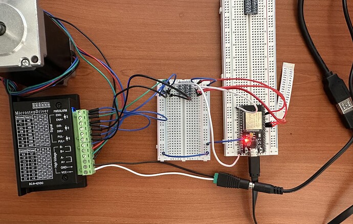

Hello, I am using an ESP32 a TB6600 micro stepper, and a Nema 23 stepper motor, I am trying to drive the motor with the esp32 but the TB6600 requires a 5v signal, I tried to fix this by using a logic level converter (specifically thisthis) but when I attempt to drive the motor I get a very slight hum out of the motor and no movement.
The motor controller and motor both work as I tested it with an Arduino Uno.
  pinMode(15, OUTPUT);
  pinMode(16, OUTPUT);
  pinMode(17, OUTPUT);
  digitalWrite(16, HIGH);
  digitalWrite(15,LOW);
  digitalWrite(15,HIGH);
  digitalWrite(17, HIGH);
   delay(200);
Picture of Circuit
Circuit Diagram

The sound emanating from the motor is not one of trying to step the motor too fast like a whine but instead a low buzz/hum
Your diagram seems to be missing a ground connection.
Your picture looks awfully like you've left off a ground connection.
Please draw a proper schematic as best you can, with particular attention to what is supplying power and how that power is being routed to the devices that require it.
a7
Im not sure what you are referring too, in the circuit diagram I neglected to add my VCC and GND connection which is 24V 1A but that is all.
You need to show the full drawing of what you actually have - that's the only way we have to see what you're doing!
And you do, indeed, seem to have missed the GND link between your Arduino and the MicroStep driver.
@awneil No, a common ground is not needed/wanted.
This drivers has opto coupler inputs.
Leo..
You seem to have use an I2C level shifter, which is meant to sink current, not to source.
If you had connected the + pins of the driver to 5volt and the -pins to the level shifter it might have worked (with reverse logic code). Maybe better to use a level shift IC that is commonly used for addressable LED strips.
