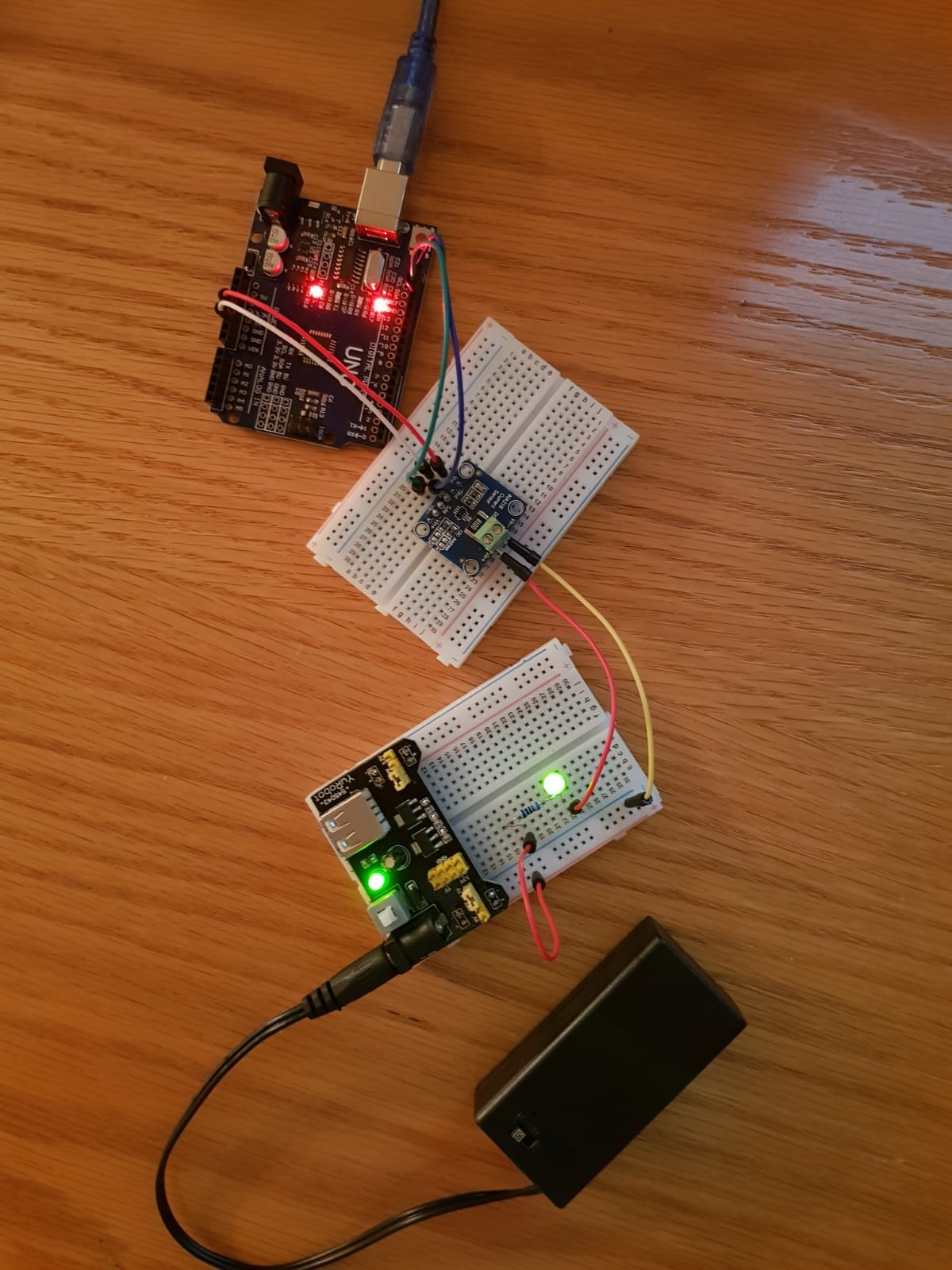

I have the INA219 I2C Bi-directional DC Current Power Supply Sensor Breakout Module. I'm trying to make it work. I made the right connections to my Arduino UNO R3 board.

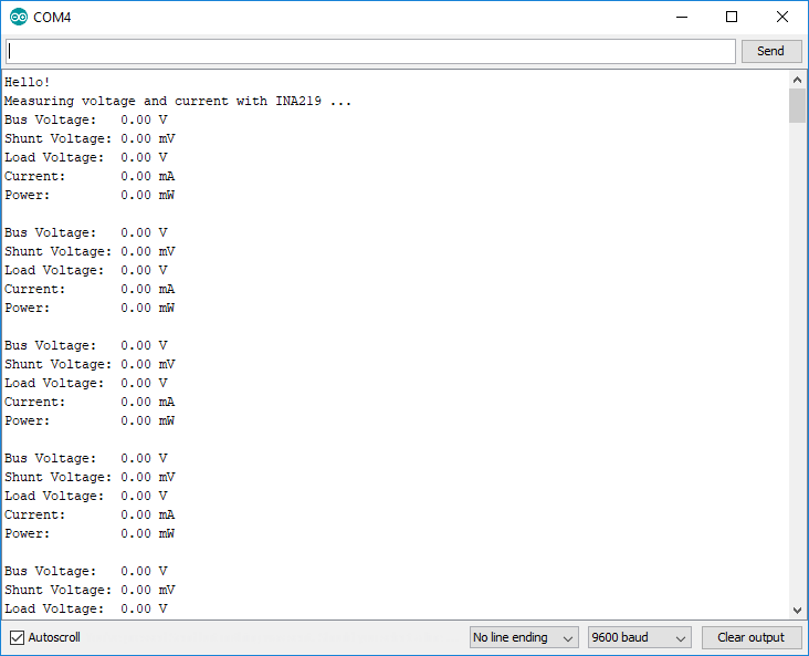

On the other hand, I have another power circuit which powers a led. It is connected to a 9V power supply which generates a 5 Volt power using MB102 Breadboard Power Supply Module. When I run the default Adafruit_INA219 getcurrent application (see code bellow), all what I'm getting is constant numbers (zeros) for the voltage and the current. Basically, it is like the chip is not functioning.
I attached all the relevant pictures. Can anybody help with what wrong I'm doing?

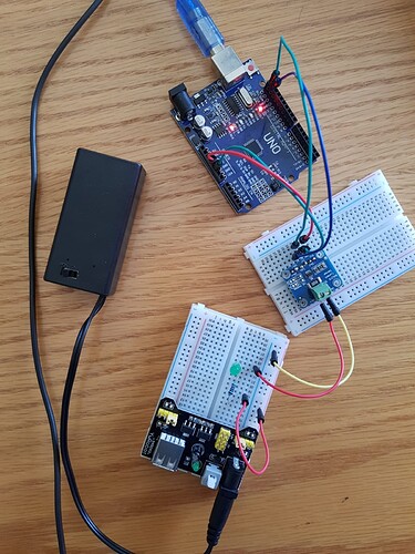

Based on picture #3, I could touch up all of your solder connections. With that complete, run the I2C_Scanner sketch and report which I2C nodes the scanner can find.

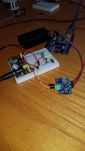

I soldered again the connections. See pictures. I ran the I2C_Scannper scetch and got the followings
Scanning...
I2C device found at address 0x40 !
done
Can you advise?
Daher.
The pictures of the connections are attached
Daher.
Does your sketch work now? I wonder how you tell the ina219 code the chip is at address 0x40. I don't see any address definition.
Hi
No it is still not working. I still get zeros everywhere.
I followed your advice to run the i2c_scanner, and using it I got the 0x40 address.

Have you found how to set, or if the address for the INA219 needs to be set, in your non-working sketch or the INA219 library?
I'm sorry for not using code tags. This is my first question at arduino forums.
I looked into the code at Adafruit_INA219.h and I do see the the followings:
#define INA219_ADDRESS                         (0x40)    // 1000000 (A0+A1=GND)
since I already got the above address in the i2c_scanner test app, then I think I don't need to make any modifications to my code since the default address is the one that is being detected.
BT, also this code doesn't work (returns all zeros)

Just to close this item. I purchased a new component and it works as expected.
