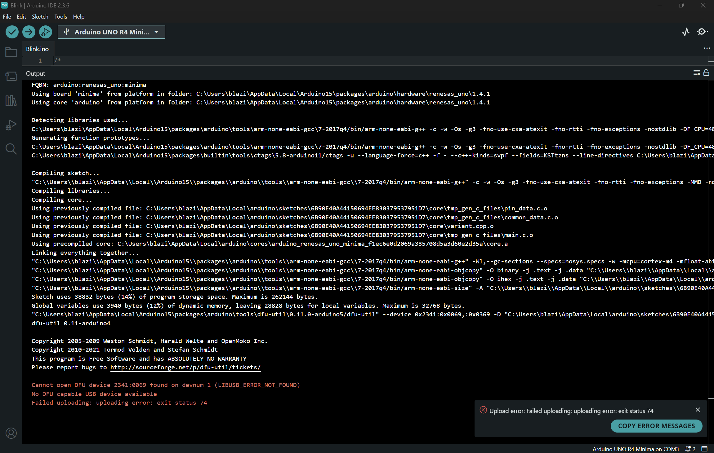

I have gotten my hands on an Uno R4 Minima board and am struggling to upload sketches to it. I am able to on a separate Windows 10 computer, am unable to on my Windows 11 laptop. On the laptop I consistently get the following error message whenever I try and upload a sketch:
Cannot open DFU device 2341:0069 found on devnum 1 (LIBUSB_ERROR_NOT_FOUND)
No DFU capable USB device available
Failed uploading: uploading error: exit status 74

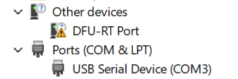

Under "Other Devices" in the Device Manager I see this:
So I believe there is something wrong with my drivers but I cannot manage to fix it regardless of what tools I use. Any advice would be amazing.

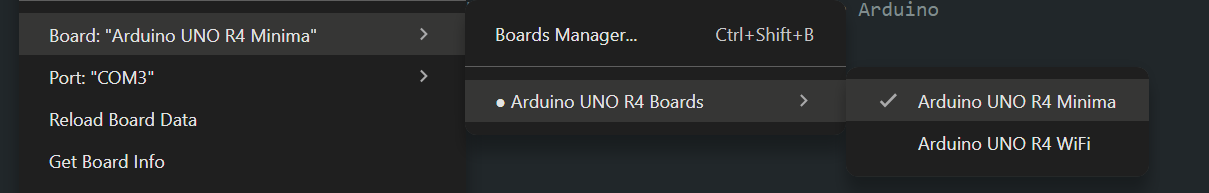

  1. Open the Arduino IDE (version 2.x recommended).
  2. Go to Tools > Board , and select Arduino UNO R4 Minima .
  3. Go to Tools > Port, and select the DFU port (if available).
  4. Open a basic sketch (like Blink) and upload it.

When plugged in the device shows as:
I tried both methods a few times but continue to get the same error as before. In the bottom right corner of the application it reads "Arduino UNO R4 Minima on COM3" outside of bootloader and the same with "[not connected]" at the end when bootloader is active.
I am unable to find a USB device named “Arduino UNO R4 Minima (DFU)” in device manager when I plug it in the three things that appear are both objects in the image below as well as a "USB composite device" under Universal Serial Bus controllers.

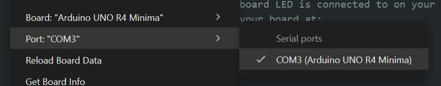

Show me the screen when you do procedure 1, then procedure 2. Don't forget to restart the IDE and Windows after each one. If it is still stuck, there is a 3rd way, but it is more technical and requires the command line and UNIX commands (yep, there is UNIX inside Windows)

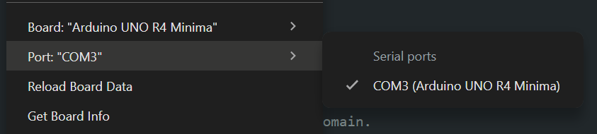

Procedure 1:
Open Arduino IDE & plug in Board.
Tools, Board, Select Arduino Board.
Tools, Port, Select COM3 because DFU is not an option
Upload Sketch & error.

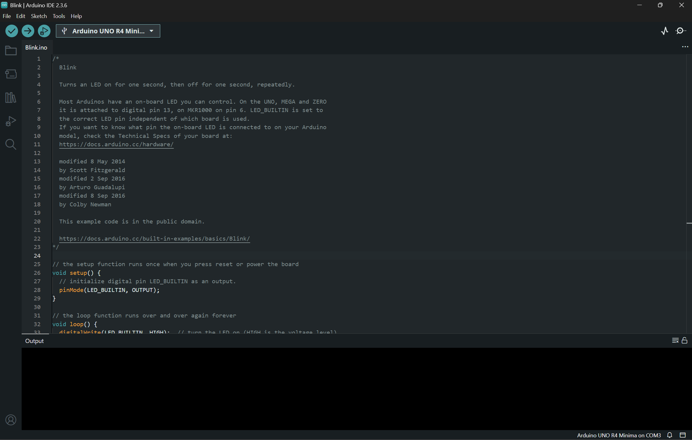

Procedure 2:
Quickly double-press the reset button to enter bootloader, the orange LED starts to fade in and out, quickly press upload & error.

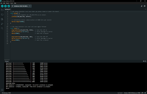

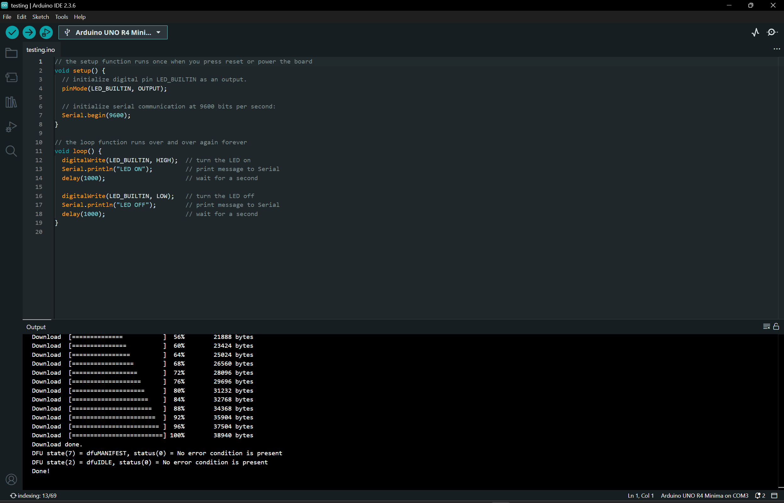

Other Computer
Unplug USB from laptop, move over to desktop, plug in, select board, upload a sketch & it works.
I believe the errors happen because of some configuration setting on my laptop or drivers. I do not understand why I keep getting the error when the device appears as a normal com port via method 1, and works on the desktop perfectly fine.
The last screen shows it worked in DFU mode. Use that computer to try to get it to normal mode.
