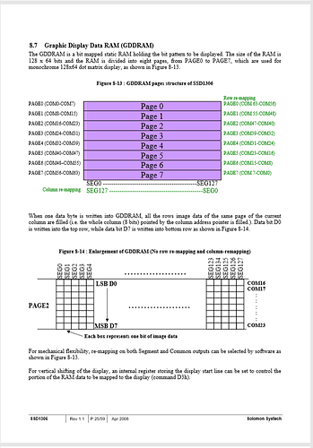

I think its a good idea to take a look at the datasheet of the SSD1306 in section 8.7 (Graphic Display Data RAM (GDDRAM) there is a description on how each bit maps to a pixel.
Thank you for the info spec sheet. I should have looked at that first but it pretty much reinforces what I read here about GLCDs.

Reading this website GLCD 128x64 | Sensors & Modules did explain it in an elegant and logical way but then it wasn't for the SSD1306 per se. But looking at the datasheet for the SSD1306 which Rintin kindly pointed me to, I believe it to be the 8 vertical pixels (LSB to MSB) per page multiplied by 128 segmented columns. Hence for the full 8 pages, we get 128 x 64 pixels.

Yes, that explains how the memory is organised in a SSD1306 or KS0108.
The library will set or clear pixels in the SSD1306 according to this memory layout.
