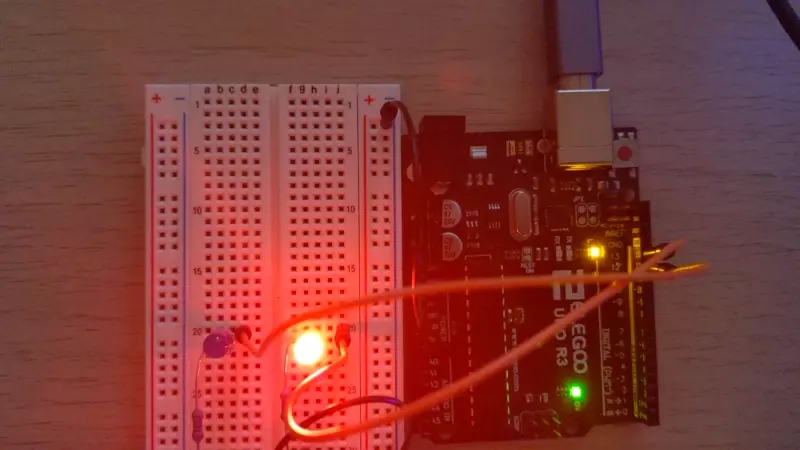

In order to express my problem more clearly, I have changed the code to this:
volatile uint8_t stop_counter{0};
ISR(TIMER1_COMPA)
    uint8_t counter{stop_counter};
    if(counter < uint8_t{2})
        portb portb{};
        portb.PORTB4.flip();
        portb.PORTB5.flip();
        stop_counter = counter + uint8_t{1};
I have also uploaded a 10s video of what is happening:
isr-issue-blinking-leds
As you can see, after the board has been programmed, the LEDs are flashing for the remainder of the video. However, the video is 10 seconds long and in the modified code above I changed the condition to make the LEDs blink when the counter is less than 2.
