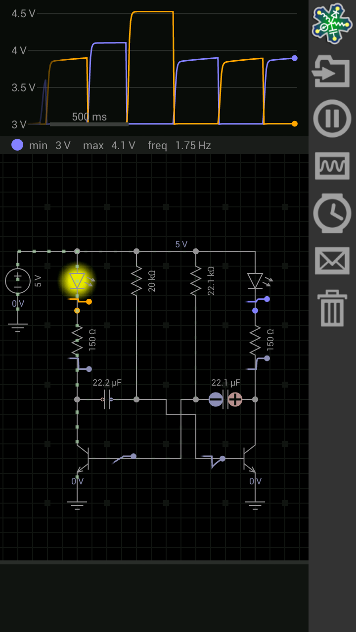

I'm trying to understand the following flip-flop circuit using 2 NPN transistors as explained in this video :
My apologies for the lengthy post. I noted down all the things that weren't clear to me as questions in this post (Q1,Q2,...)
The full circuit diagram:
After applying power, 1 LED (the right one) is lit.
Reasoning here is that this is the case because only 1 transistor is switched on.
In this case the right transistor is turned on causing the right LED to turn on.
Q1 : Am I correct in assuming the LED is lit up because of the following current flowing:
Vcc -> right LED -> right 470ohm -> right Collector -> right Emitter - 100Ohm - GND

Put simply when the transistors switch over there is positive feedback. if the left transistor starts to switch on
its collector voltage will drop, which then brings the base of the other negative by the same amount (capacitor),
so the right transistor switches off, which causes its collector to rise, bringing the left transistor base high
(turning it on more).
This feedback is very rapid, the circuit snaps over to the over sense. The capacitors start to discharge through
their respective capacitors till the opposite switch over is initiated as the negative drive peters out on the right
transistor, causing it to start conducting, pulling its collector down (which pulls the base of the left transistor
lower and 'snap' again.
Vcc -> right LED -> right 470ohm -> left 10K resistor ->left base transistor.
Current will only flow through the left transistor base if the Base voltage is at least 0.6V higher than the emitter voltage.
Since the Right transistor is ON, it's Collector voltage (which is the same as the left transistor's base voltage) is only about 0.2V, so it does NOT turn on, and no current flows. (Note that these voltages are relative to the emitters of the transistors. Since there's an extra 100ohm resistor to the actual circuit ground, the voltage compared to "ground" will be higher.)
