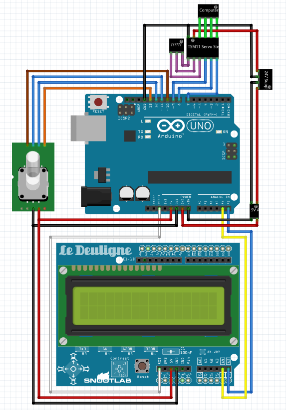

I'm trying to use a stepper motor with integrated driver to move a platform to desired angles. I've previously used a stepper with a separate driver, so I understand how to use the Step (X1), Direction (X2), and Enable (X3) inputs to produce the desired motion.
This motor also has RX & TX connections, though, and I'm not sure if I also need to connect those somewhere. Are those only used when connecting via RS-422/485? Will they send back information from the servo? If the Step, Dir, Ena wires produce the desired motion, is it acceptable to leave the RX/TX wires unconnected?
Other details about the project: I'm also using the arduino to collect information from a CUI AMT20 Series encoder via the ICSP pins. I'm pretty new to all of these systems so tips/tutorials would be appreciated.

I believe you may be referencing the diagram labeled "Connecting to a Controller with Sinking Outputs." I was going to follow along the lines of the one further down labeled "Connector Controlled with Differential Outputs," with X1 (STEP), X2 (DIR), and also X3 (ENA) connected to pins 5-7 and their respective negatives to GND. The Arduino pins don't put out 24V so that wouldn't be an issue. Does this setup not qualify as differential outputs? I didn't think Sinking Outputs applied to this situation.
I've made a wiring diagram that I hope will help to clarify.

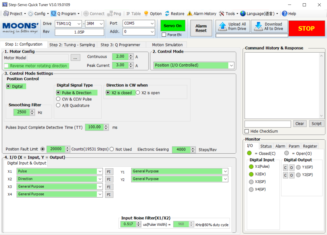

I started experimenting in the software as soon as I received the RS-422/485 to USB converter. It will only respond predictably to the sample button meant for tuning. I've tried configuring it in "Pulse & Direction" mode and "CW & CCW Pulse" mode, but it won't respond to the pulses from Arduino.
The most successful result I got was in CW/CCW mode with this sketch:

I realized that I hadn't connected the motor ground (V-) to the arduino ground which improved things considerably. I'm now using an adaptation on the Sweep example sketch, with the HI/LOW value sent to X2 determining the direction of rotation as I've used before for stepper motors. However, instead of moving 180 degrees back and forth it's making full continuous circles at a constant speed. Neither the speed nor the travel change when I change the maximum value of pos or the delay.

I've attached updated schematic, sketch, and motor configuration parameters. Again, sorry to be so naggy, I just know that this forum is my best chance at finding solutions.
