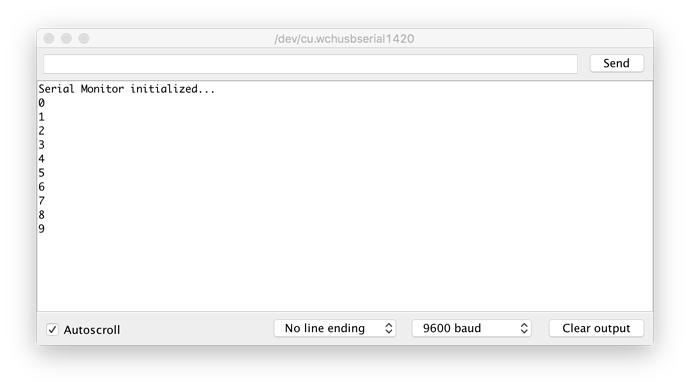

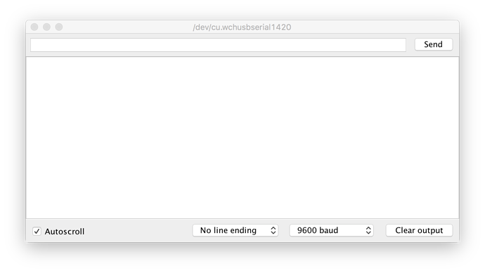

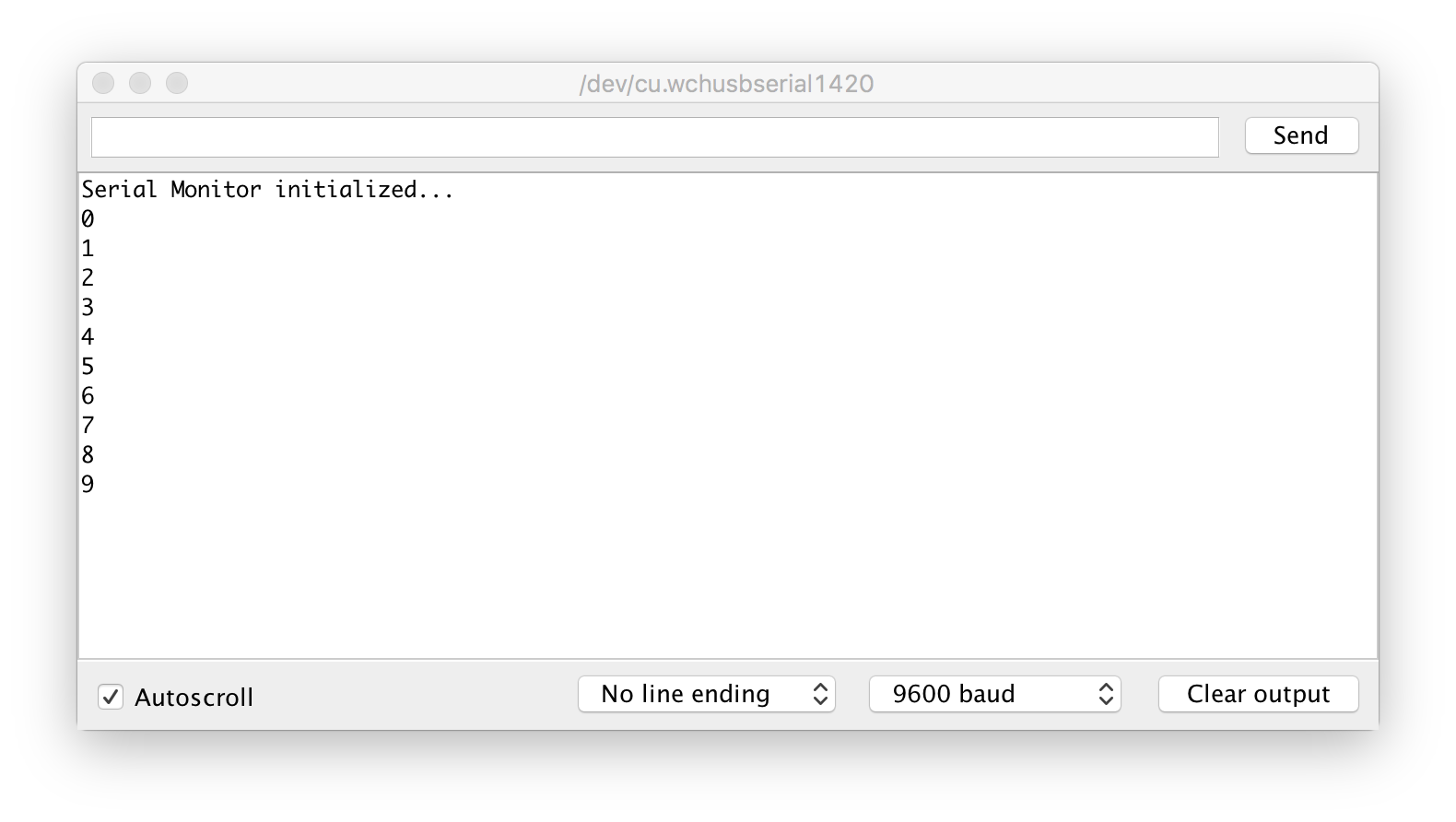

Here some screenshots of my Serial Monitor:
  1. screen: SM right after pressing the upload button (buttons inactive)
  2. screen: upload unfortunately completed, but sketch not running (buttons active)
  3. screen: sketch running
I found out, that if I use a delay below 804 millisecs, the output will be twice. 805 and above will print it only once. (I suspect this delay is only valid in my environment).
It would be very nice if someone else could check this general behavior on his macOS environment.
Besides getting this information is the question, why the monitor actually reboots without delay on my environment and unfortunately not on Windows PC.
