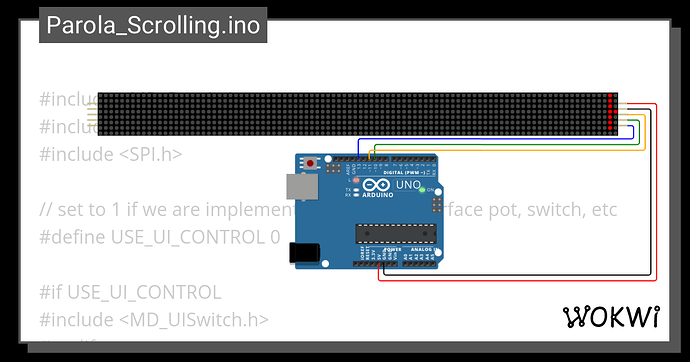

Try the MD_Parola examples and fit your code to the example.
Thanks @xfpd , I already gone through with this, but facing issues in understanding, let me try it again.

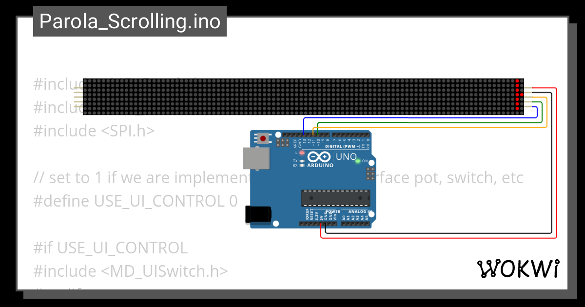

If you search on "wokwi md_parola scroll text" you will find a good simulation to test your code (you also will find many broken simulations).
Don't mix MAX72xx and Parola. They are fighting for control of the display. If you are trying to display text then just use the Patola functions. Parola also has methods to control the spacing between letters and between words. Please read the documentation in the docs folder.
Have you defined an arabic/urdui font to display? I don't see that in the code.
Thank you all who provide support, After reading it while sitting alone, I figure out the mistake that I was doing :slight_smile:
