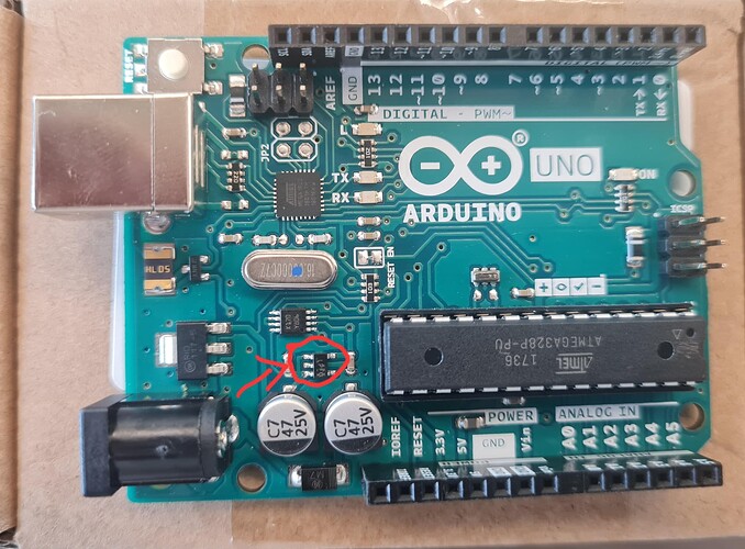

Whenever I connect the board using a USB it heats up real hot (sometimes shuts itself off. When if doesn't shut itself off I smell some burning smell and pull the cable out). The part circled in red below is where the heat builds up.

Did you have problems with the motors? How were they and the Arduino powered? Can you get a clear view of the hot part or post its number? I think it is a 3V3 regulator but I cannot be sure.

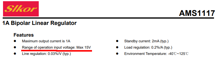

24v is indeed out of spec.
Look at this documentation on powering the UNO.
https://learn.adafruit.com/ladyadas-learn-arduino-lesson-number-0/power-jack-and-supply
The max voltage on the power jack is 20v but it is stressful on the board. 9 to 12v is much better.
Ye, it is the 3.3volt regulator. The Uno only uses it as a reference to turn off USB suppy when the Uno is powered externally.

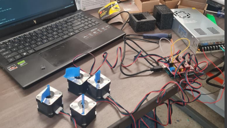

Show us how what and where you connected this stepper.
Maybe you powered the stepper throough the Uno, which cold explain things.

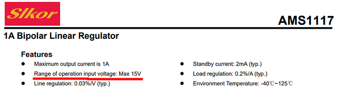

The datasheet for the 5V regulator that could be on your Uno says otherwise.

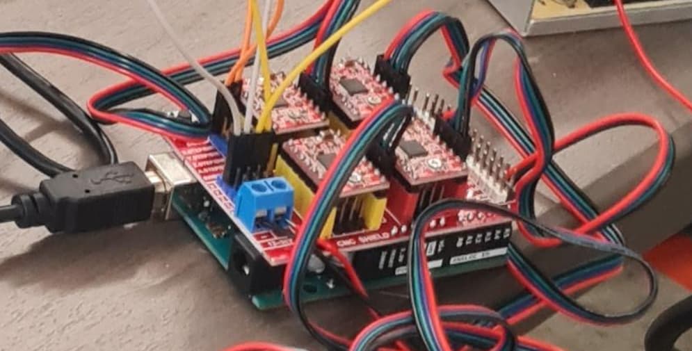

Clarification: The Arduino was not connected to 24V. The 24V was connected to the CNC shield (which is rated for 12-36V). Arduino is only connected to 5V through the UBS cable. Even after I remove the shield and the 24V power (only running on 5V through the USB cable), it still heats up
I know these are not the best images, this is from a video I took. (I left the UNO in the campus for the night). Let me know if you want explanation in any connection.
Remove the shield and see if the Blink sketch still works.
If so, then the Uno is still OK, except for the 3.3volt output.
That 3.3volt chip is not used for anything when the Uno is powered via USB.
You could swipe that 5-pin chip off the board with a soldering iron.
