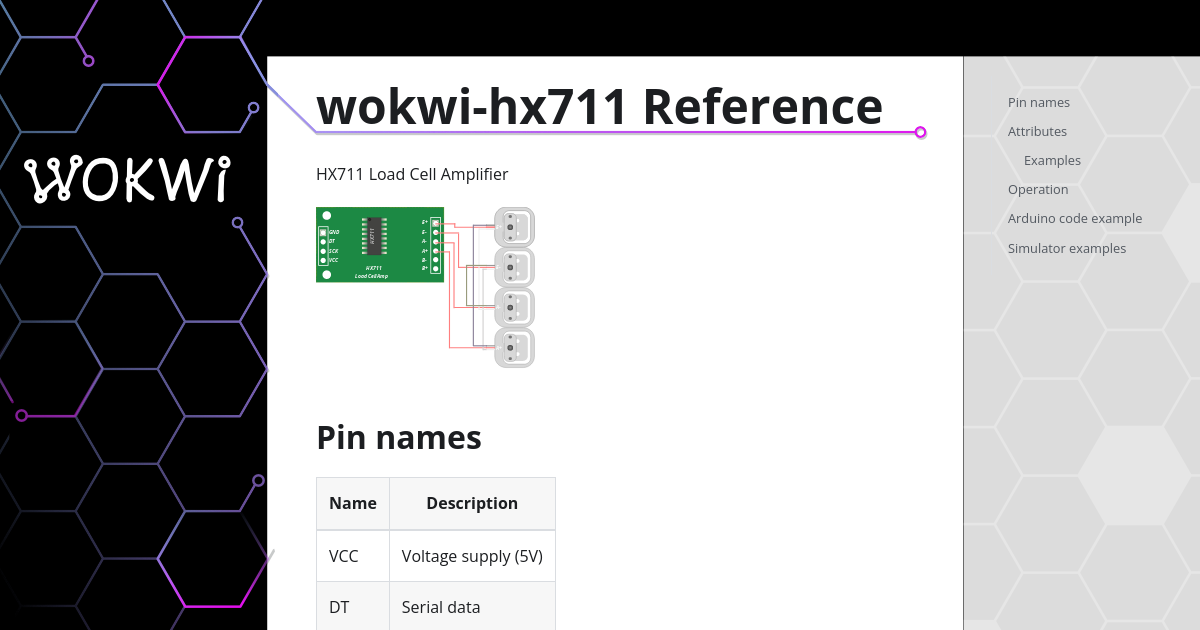

Visit
scroll down and try the examples.
If you can do that and find it to be fun, maybe then buy the same parts for realz and see if it is still fun.
