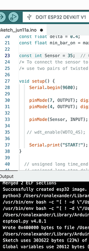

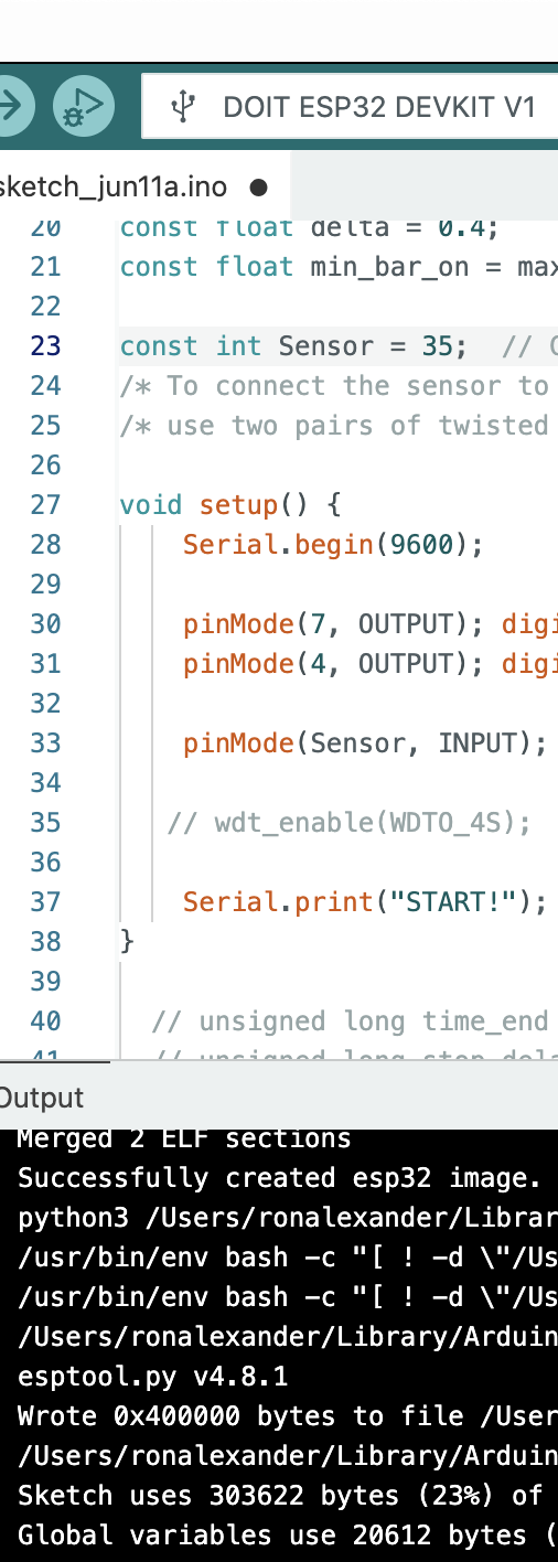

Here is proof the sketch compiles BUT I removed wdt.h, it isn't used.

And here it is for the esp32. One change is A2 is now 35 which is GPIO35.
can not read your code did you include wdt.h or not I can complle if I do not use thre wdt.h

My code is your code with the one change
//#include <wdt.h>

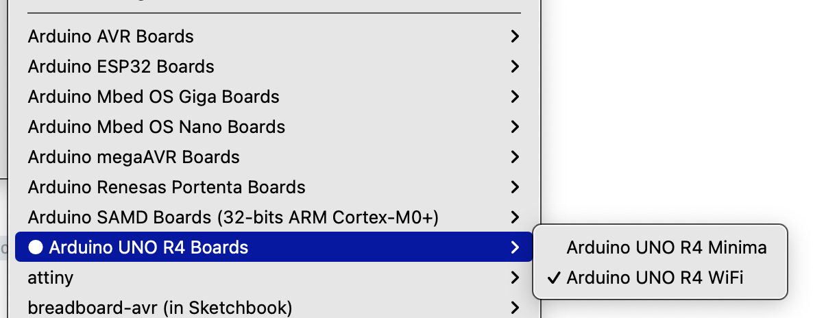

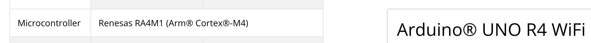

Here are some informative screen grabs

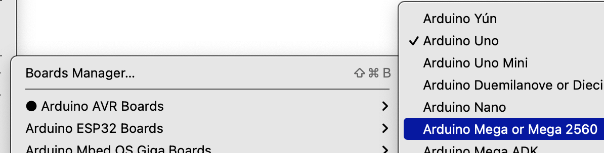

whereas AVR is
The UNO R3 is a different platform than the UNO R4 as seen in the following two screen grabs

WARNING: library WDT claims to run on renesas architecture(s) and may be incompatible with your current board which runs on renesas_uno architecture(s).
