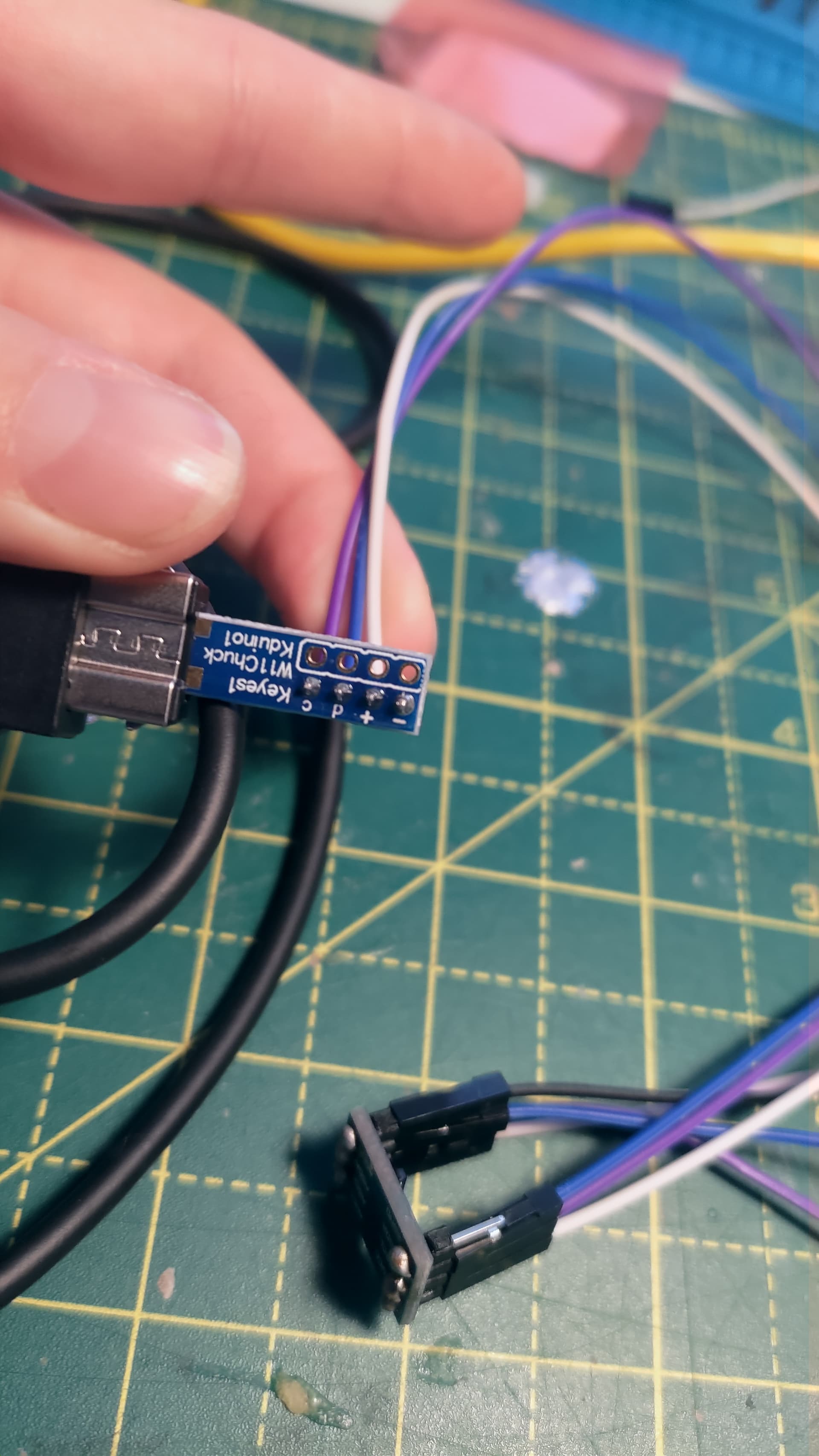

If that's true, you didn't connect it properly:
The power and ground wires should be on the outer pins and the I²C lines on the inner pins.
I've gotten home and tried to wire it again, triple checking that my wires are in the right place, but still no luck. I also tried with and without a ground wire back to the Arduino, and just in case, the ground wire between the shifter and nunchuk. I've taken photos of my wiring for the version where neither ground is connected. White is 5V, Black is ground, Blue is data and Purple is Clock. As I'm having so many issues I'm going to try and problem solve with the sparkfun board, as that at least came back with data even if it was wrong.
EDIT: I am no longer using this blue level shifter as I couldn't figure out what was wrong. I am now looking to use the SparkFun level shifter instead, as discussed below

The PCB is connected into the socket the right way around?

Hi Tom, I've got one on the way but it won't be here now until mid next week. By PCB and socket, do you mean if the pins I've soldered in are the right way around? It was a second attempt at soldering the board as I accidently damaged the first one with too much solder, so I flipped the board to avoid making the same mistake.
I can just use the sparkfun board level shifter instead, but the data is coming back wrong at the moment, just trying to troubleshoot why if I don't have the tools to fix the smaller board in the diagram. I'll get onto that drawn version in case it helps at all
