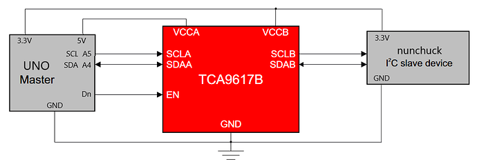

Could this be an alternative? TCA9617B
There's no limitation on VCCA and VCCB as to which needs to be the higher voltage, so its easy to wire up for highV (UNO) to lowV translation. Also, there's an EN (enable) pin that can be used to isolate a badly behaved slave on power-up reset.
It could be, but that is quite irrelevant. There is no reason whatsoever for the common level converter not to work if correctly wired.

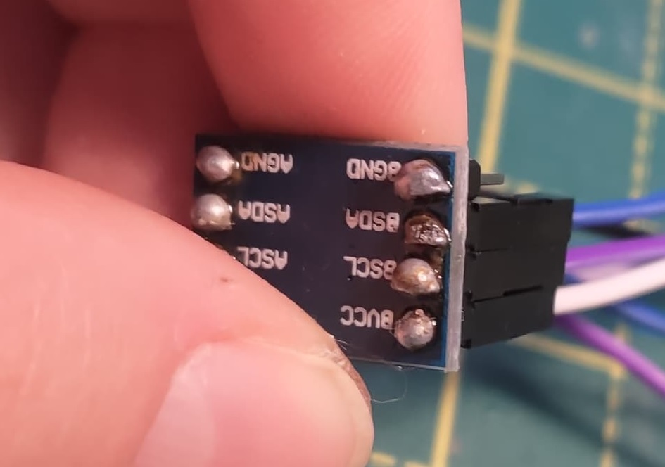

Speaking of which, his photos indicate no ground (negative) wire between the WiiChuck and the level converter. As most of us realise, there is no "option" as to whether all grounds need to be connected from one part to the next - travelling bundled together with the supply and data wires.
The suggestion of the correct level shifter being added to the circuit resulting in alteration of the digital I²C data is most bizarre indeed. Presumably what was happening is that faulty communication is actually causing bit shifting conflating data from different registers.
And it is I suppose possible that incorrectly driving with 5 v levels while the ground connection is missing may ameliorate the overloading and "fudge" correct operation. :dizzy_face:

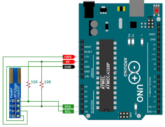

In this tutorial, the WiiChuck was connected directly to the UNO. It appears the WiiChuck's I2C lines are 5V tolerant. However, I would add 10K external pullups if this is the only I2C device in the circuit.

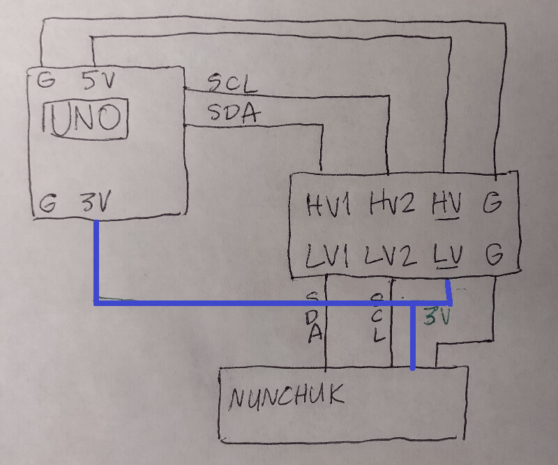

I've made a new diagram for just this part of the circuit, all I'm looking to solve right now is being able to accurately print the slave data to the monitor. As the smaller blue board was giving me so much trouble, I'm just going to use the sparkfun board. In case my soldering job caused the issue, I've ordered a second clean board that I'll get some help with attaching the pins next week

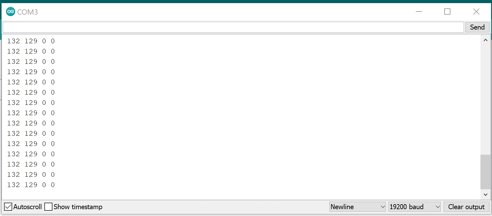

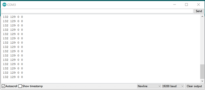

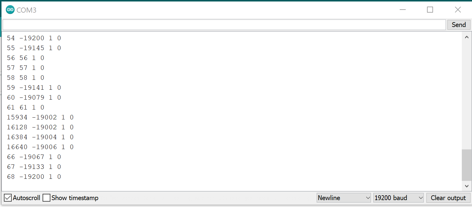

When I run this code on just the 3.3v pin with no level shifter, I get this data back in the board, and it accurately updates when I move the joystick or buttons. This is exactly the data I want
Then, when I use the 5v pin and the shifter, I get this data back. I don't feel like the data is random as it goes between the same numbers.

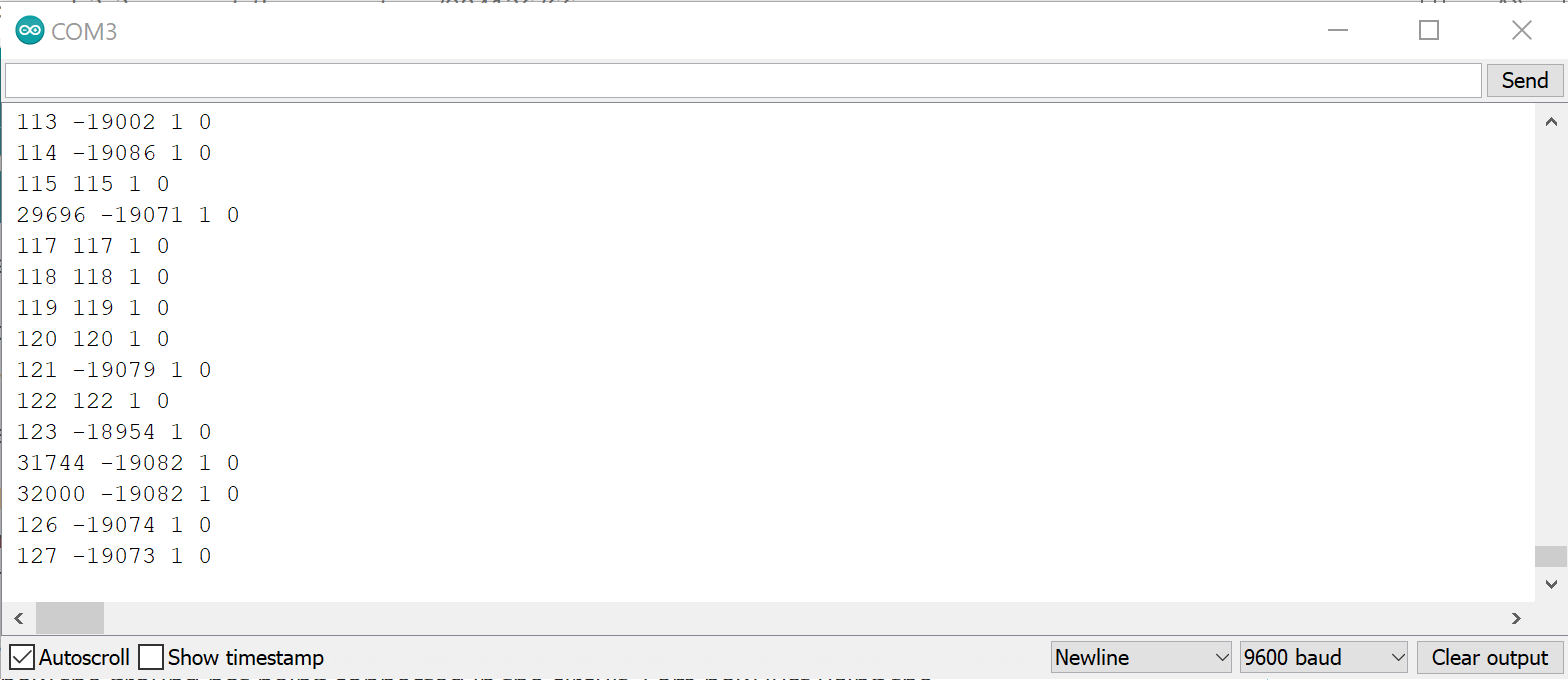

The shifter would add some timing lag to the signals. Looks like its sometimes printing your baudrate of 19200. Maybe lowering the baudrate would work:
#define BAUDRATE 14400
or
#define BAUDRATE 9600

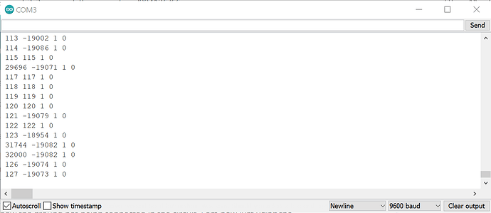

Just tried altering the code to use 9600, this is the result this time. Using the joystick or buttons seems to have no impact on the numbers being printed

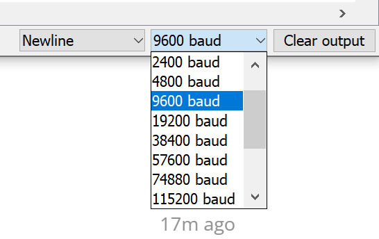

I can't see 14400 in my drop down menu in the monitor, how would I set the monitor to a custom amount to try 14400 These are the options I have
Sorry, but what does the baudrate have to do with I²C communications? :face_with_raised_eyebrow:

The DWG in Post#66 does not show any connection between
your device's 3V and level-shifter LV back to Arduino 3V.
Accurate or Oversight?
PE - Oof, I guess there's something that maybe has 3V for that as part of the deal (weird). Hard to keep up. Well, all mine have only ever had the 3V supplied externally, always work. Anyway.
It is clear from the OP's pictures that there was no ground connection between the level shifter and the adapter board that connected to the wiichuk, that alone would cause erroneous readings. Four connections are necessary, power, ground, and the two I2C lines, or it will never work correctly.
I understand this, and as stated, I was following the advice of the schematic to not attach the LV ground on the board. I tried adding it back in, just connecting the nunchuck to the Arduino etc. I'm no longer looking to use the board in the pictures, and am attempting to get help regarding the SparkFun board as discussed above :slight_smile: the photos aren't really relevant anymore, I'll edit the post with a note now

As I thought, and as david_2018 seconded, the BOB-12009 requires 5V, 3V, and GND
PE -- Adding DWG
This has fixed it! Thank you so much! It's working!
