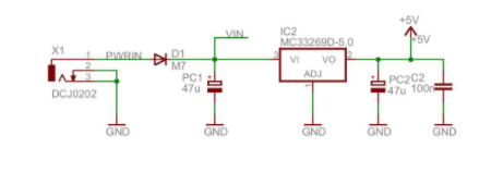

Should the Vin pin of the Arduino Uno have the voltage of the external source, or 0.7 V below due to protection diode?
My board works fine but a multimeter at Vin reads zero volts. Is it defective? All other power pins present the expected voltages.
I'd like to route this voltage to an analog input thru a voltage divider to show a battery level on the display.
It should be 0.7V lower due to 'D1' diode.

Trace the Vin pin back to its origin, visually then with the resistance range on the DVM.
Confirm Vin has continuity to the cathode of the Vin diode.

Neither by eye nor with ohm meter I found any continuity with this Vin eyelet. And from schematic sent by @missdrew (upper left) it should also read 20K between Vin and ground, wich I find open at the eyelet and 1.56k between ground and pin 3 of 5V regulator.

Maybe place an ohmmeter lead on the Vin pad and probe around to see where it might go.
For example the power jack leads, diode anode/cathode, capacitor leads etc.

For that particular clone board, the pad that you have the red probe on is connected to the cathode of D1 with a short (~2mm) trace on the top side of the board - that connects to the Vin pad of the female connector. If the connection between those two Vin pins is open, yes, you can jumper them together with a thin wire on the back side of the pc board.
It could be that the trace was damaged when the female connector was installed. The plate-thru via could have been damaged or faulty although most of the boards are tested for continuity as part of the post fab QC of the bare board. For $5, the quality is typically quite impressive IMO.
You do NOT have an Arduino product. You have an off brand clone/copy/fake. Without their schematic, all information I supplied is void.
Thank you all for your help. I tried each and every clue suggested to no avail. My conclusion is the clad is indeed isolated so I'll add the jumper. This clone has not even the reverse polarity protection diode, power goes direct to 5V regulator input.
