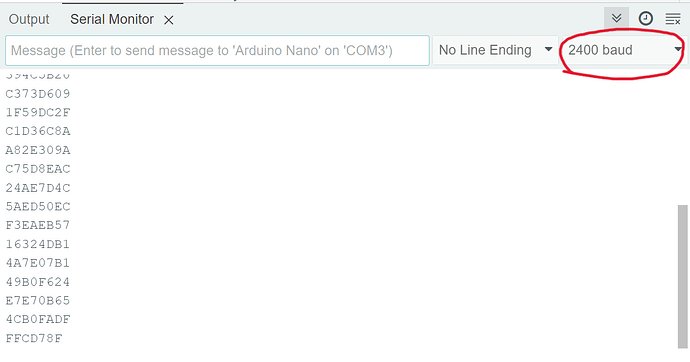

These are received signals with 5V power. The signals came from somewhere and my IR remote control.
These are signals with 3.3V power. they were responses from one button (button 0) of my remote control only but they were unstable.

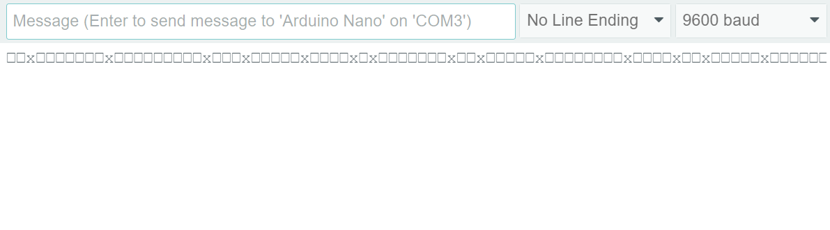

Apparently you weren't able to actually match the baud rate with your serial monitor. Pic related.

This might be my computer fault at very first. I always use 2400 baud Serial Monitor when Serial.begin(9600) and it works better than 9600 baud Serial Monitor. If I change to 9600 baud, the received signals will go unrecognised like this.

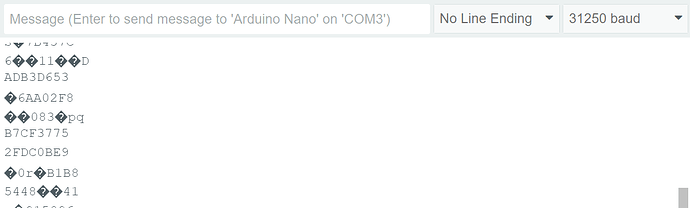

So what do you set your serial monitor baud rate to if you want to use Serial.begin(115200)?
The most suitable baud rate at this point is 31250 baud. However, some unrecognized characters somtimes appear on the received signals' string.
Well, I can't tell you exactly what your problem is with the IR receiver then, but I would say that investigating your baud settings is a great place to start. It seems like something is seriously wrong here between your device, your Arduino, your computer, and your Arduino IDE. It's hardly worth trying anything else until you can your serial monitor baud rate to match your Serial.begin baud rate.
