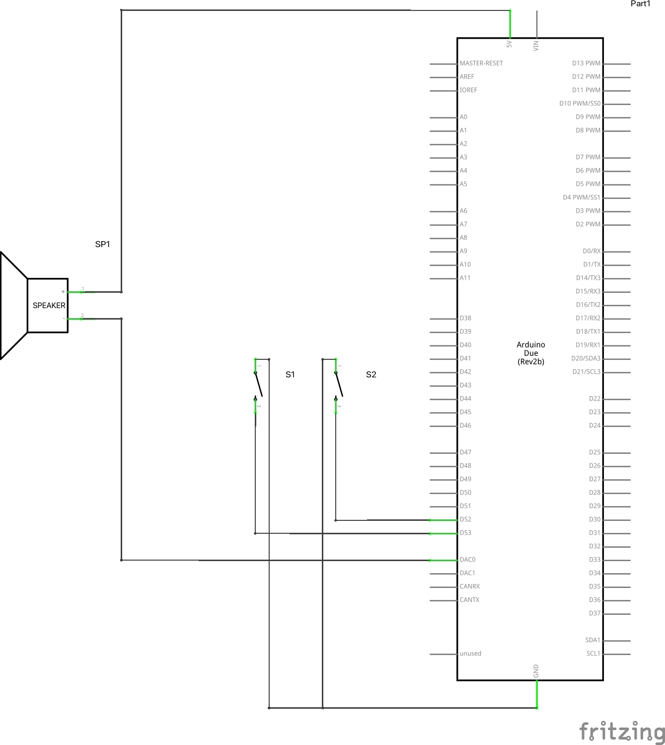

I wasn't sure how to depict the inputs. They're not actually switches, they provide digital inputs. The speaker here really is an amp going to a speaker.
upload a schematic of the circuit? how do you power the device?
Alright, drawing the schematic will take me a bit. I power it from a 12V power supply. But if that was the issue, there would also be noise before playing a sound for the first time, wouldn't it?

I added a schematic. Moreover, while doing so I realised that I might have wired the speaker incorrectly. It should probably go to ground, not to 5V, am I right?
I see no schematics. Where did You post it? Posting in the last reply is prefered.
You need a capacitor in serie with the speaker, else it might get damaged. Then GND or posive is no big difference I think. Use GND.
Found it. The most appreciated is posting it as a picture. Downloading is not popular. It fills up helpers equipment...
Being coockied is no, no here... Picture please.
You will eventually burn out the output pin by driving a speaker directly, and possibly destroy the Due as well. Use an audio amplifier to drive the speaker.
Done!
Sorry, the schematic was simplified. The DAC output goes to an amp.
Ahh, you expect intelligent, thoughtful answers about problems with your setup, but can't be bothered to provide accurate details.
Please explain this statement:
Second time....
Wow, that seems like an awfully negative way of seeing it. Why do you think I can't be bothered to provide accurate details? Do you instead mean that I did not provide accurate details initially (because I didn't know better), then apologised and provided the details you were asking for? As I said, I greatly appreciate your help, but that statement doesn't seem to be very productive.
Explaining my statement about the DAC output wiring: I was asking if the output is wired up correctly like that or whether I should connect the positive pin of the amp to GND as opposed to 5V on the Arduino side. As I explained in my first post, I'm worried that the voltage at the DAC output is fluctuating, and now I was asking if connecting it to GND might prevent that. Railroader suggested to try that.

Noise is often a problem with electronics, especially abused electronics. Like, for example, connecting the output of an amplifier to the positive terminal of a power supply.
For help with your problem, post a complete, accurate schematic diagram of your setup, with links to the components, such as the mysterious amplifier.
