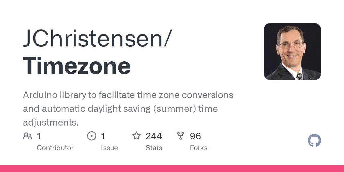

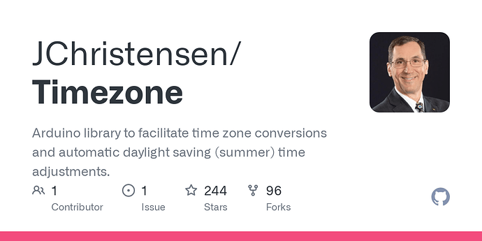

Daylight savings time can be easily handled in software.
See:
Sure, this can handle the DST. =]
