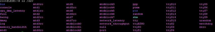

I add that I tried to reinitialize the distribution OpenWrt-Yun to its out of the box state by pressing more than 30 seconds on the button "Yun-RST": without success since apparently this action does nothing on LEDE-17.01.6 or brings the state to the last flashed image ie 17.01.6.
And... effectively this is the last flashed image that reappears ...
so if we see the good side of things, I still have the terminal (on br-lan not eth1???) ( and the YunSerialTerminal (from Arduino Side)
root@LEDE:~# ifconfig
br-lan Link encap:Ethernet HWaddr A8:40:41:19:D0:F0
inet addr:192.168.1.1 Bcast:192.168.1.255 Mask:255.255.255.0
inet6 addr: fe80::aa40:41ff:fe19:d0f0/64 Scope:Link
inet6 addr: fdec:32fb:5e99::1/60 Scope:Global
UP BROADCAST RUNNING MULTICAST MTU:1500 Metric:1
RX packets:4218 errors:0 dropped:0 overruns:0 frame:0
TX packets:2681 errors:0 dropped:0 overruns:0 carrier:0
collisions:0 txqueuelen:1000
RX bytes:560622 (547.4 KiB) TX bytes:564747 (551.5 KiB)
eth1 Link encap:Ethernet HWaddr A8:40:41:19:D0:F0
TX packets:2676 errors:0 dropped:0 overruns:0 carrier:0
RX bytes:621798 (607.2 KiB) TX bytes:564181 (550.9 KiB)
Interrupt:4
lo Link encap:Local Loopback
inet addr:127.0.0.1 Mask:255.0.0.0
inet6 addr: ::1/128 Scope:Host
UP LOOPBACK RUNNING MTU:65536 Metric:1
RX packets:1124 errors:0 dropped:0 overruns:0 frame:0
TX packets:1124 errors:0 dropped:0 overruns:0 carrier:0
RX bytes:73508 (71.7 KiB) TX bytes:73508 (71.7 KiB)
I think the game is over!
