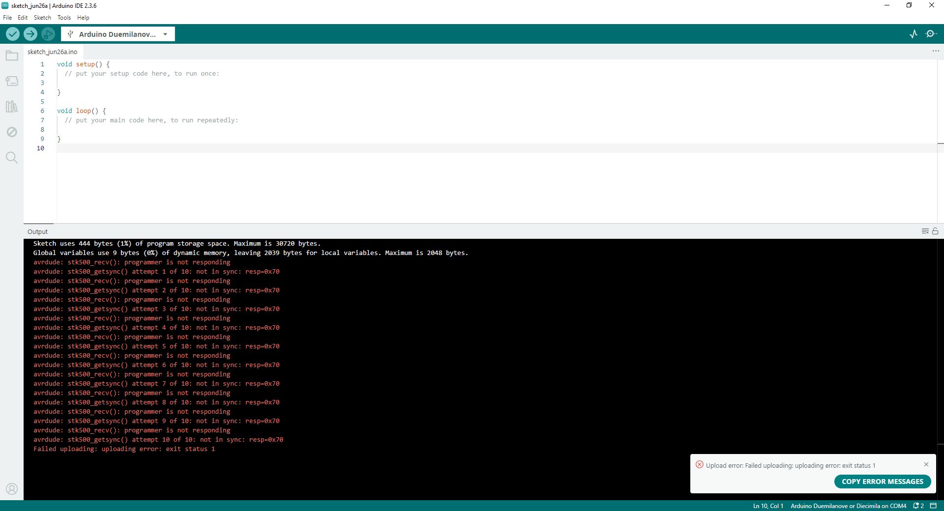

I am trying to upload a sketch within the Arduino IDE 2.3.6 to an Arduino Diecimila. First i have selcted my Board and the Port in the Arduino IDE:
The sketch looks like:
Compiling the Code is wroking without an Error. But when I upload this simple Sketch i get an Error Message:

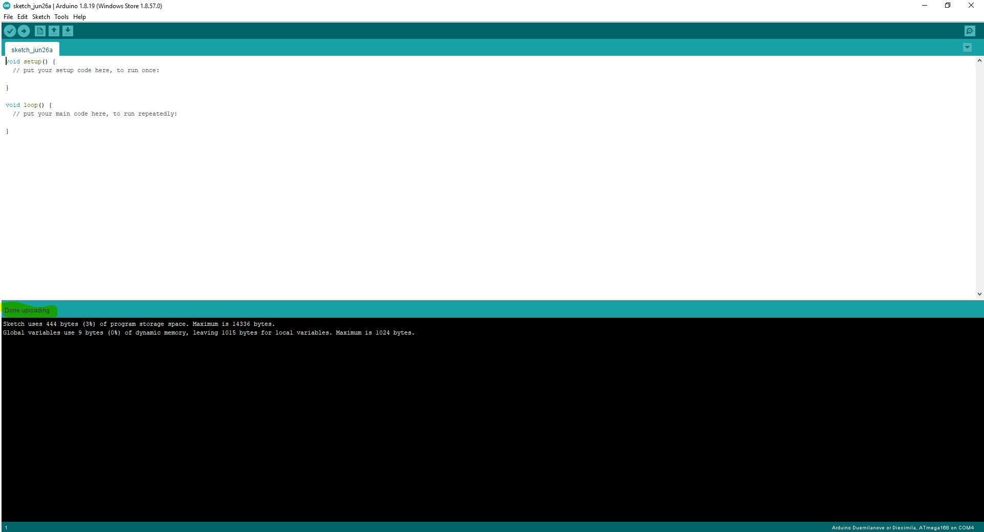

When I am using the same Sketch in the Arduino 1.8.19 version i am selecting the Board: Arduino Duemilanove or Diecimila , Processor: ATmega168 and Port: COM4
Then Compiling and Uploading is working fine:
Any Idea how to get the Arduino IDE 2.3.6 working for my Arduino Diecimila ?
I’m not familiar with your board but did you select the correct processor?
In the Arduino IDE 1.8.19 I can find the Processor Options in the tools menu. But how do I select the processor in the Arduino IDE 2.3.6?
Same way
Alright I have overseen that. Thanks, now it does work.
