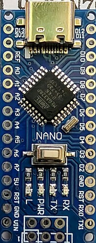

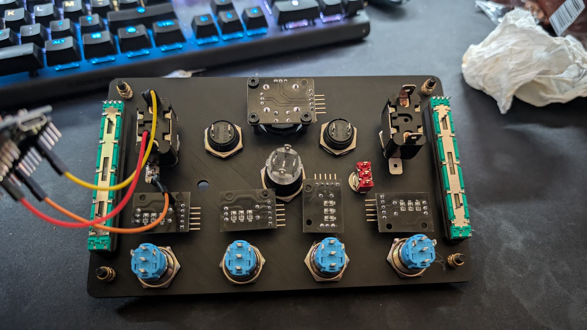

Thanks, you want to know waht button I am using ? or just the controller ? I can upload a picture if you want. But, I'm stuck with the arduino upload. And I'm not sur what Arduino ctronller I am using (not the same than the link on my first post)
send a picture please and I will be able to write a code for you!
Really ? Nice, thanks :slight_smile:
okay! correct me if I'm wrong but I am seeing some push buttons, a joystick, a rocker push button, and some switches.
the five buttons on the bottom are momentary buttons, just above, incrementiale with a push, juste after 2 momentary ON OFF ON , and Start Engine Momentary, above 2 momentary (black) 2 "On OFF" (Red) and a stick with push button
very cool I will write your code if you could give me about 5 minutes!
can you actually send the picture of the Arduino board you are using?
yep, uploading is on the way. I forgot the 2 potentiometer vertical on the two sides
its fine I saw them!
from the first picture I sent, it looks like you are using a nano but I would need another pic to be sure
yep thats a nano I will be right back!

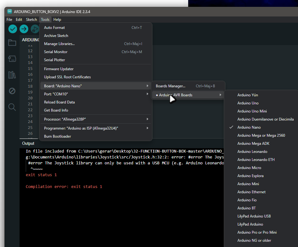

Ok, but, when I try to do a verification, I have an error. So anoying
Hi @grumpindaface.
Is this a picture of your board?
I am asking because this picture is of a clone/derivative of the classic Nano board, but the product listing title you referenced is for a clone of the Pro Micro board.
It is important for us to understand which of these boards you have because they have significant technical differences. If your board is a Nano, then the error message you encountered while attempting to upload to it with Arduino IDE configured for use with the Pro Micro is expected.
Yes, this is a picture of my board. And this is not the same than my amazon picture purshased.. thx amazon . .
