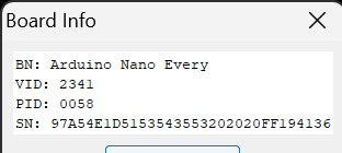

I'm having trouble uploading to arduino.
The port and board are correct, and Register emulation is “None (ATMEGA4809)”.
Of course, the arduino has also been reinstalled.

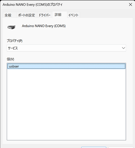

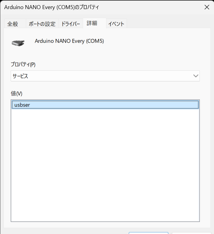

When I run it, it seems that access to the COM port is denied.
I thought it might be occupied by another process, so I checked with Process Explorer, but it didn't hit.
It has been confirmed that UNO and ESP32 can be written with arduino.

avrdude.exe: ser_open(): can't open device "\\.\COM5": アクセスが拒否されました。
avrdude.exe done.  Thank you.

In the same way, I dropped the arduino process (I am using an older version of the IDE, and the new version had the same result), but the result did not change.
I tried running it in the same way on a friend's PC and it worked fine, so I decided to initialize Windows once.
