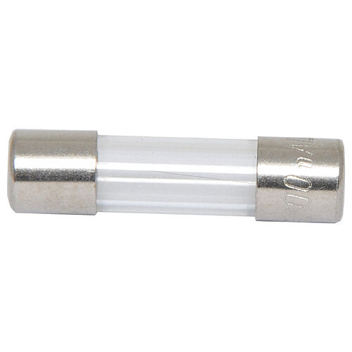

You write several times about a fuse. Do you know that a fuse is to keep a circuit from overheating and starting a fire? It can never protect a solid state device in your project. It can't react fast enough.
So, where ever there is a chance of something drawing too much current and causing a fire, that will be the place for a fuse. Between the transformer and the mains power is one good place. Another might be between a charger and a battery.
You need to know the normal current for that circuit in order to select a fuse. A fuse needs to carry the normal current plus a bit more. Fuses are current operated switches that will open up when too much current goes through them for too long of a time.
A good fuse holder is also required and the style will depend on your project.

What would the size of the fuse be betweeen the mains AC 240v and the transformer, is that the 500ma fuse they talk about in the manual?

The M 8587, SLA charger, comes with a 10A fuse, it says. I guess this one is intended to be placed between the transformer and the charger to protect the charger? Then the 500ma fuse, S5714, recommended in the manual for the transformer, M2170L, goes between the mains AC power 240v and the transformer?

fuse recommended for the transformer:

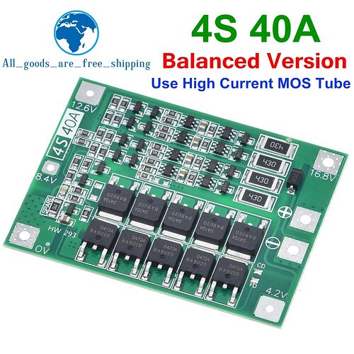

What makes this thing a lead acid battery charger and not safe to use with for example Li-ion batteries? Would i need to add additional BMS such as this one between the battery and the charger?
