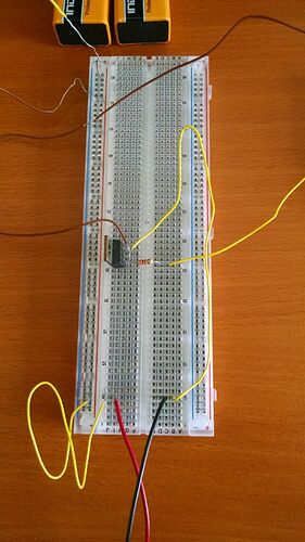

Hey guys, thanks for the quick responses!
I've managed to take a couple pictures of the setup. The brown wires should all be connected to ground, and the yellow wires should be carrying positive current.
Also, a correction: the transistor is not a TIP 120, it is a Fairchild MJE3055T TO220. (https://www.fairchildsemi.com/datasheets/MJ/MJE3055T.pdf)
@TomGeorge: The voltage across the solenoid when it is on is ~34 V. My issue is that I cannot get it to turn off via the Arduino : )
And, indeed, the collector is LOW when pin 4 is HIGH (4.9 V) - however, I am not sure why or how to resolve this. Is it possible the resistor (3.3k) is too strong?

Place the EMITTER of the 2N3055 to gnd, the BASE to the arduino via the resistor.
The COLLECTOR of the 2N3055 to one side of the solenoid, the other side of the solenoid to battery.
If BROWN is GND then you have COLLECTOR to GND.
The 2N3055 looking from the front is BASE,COLLECTOR,EMITTER...Note the Heatsink Tab is also COLLECTOR.
You also need a diode such as 1N4004 connected across the solenoid terminals, CATHODE of the diode to the SUPPLY side of the solenoid, the ANODE connected to the terminal of the solenoid that connects to the COLLECTOR.
To protect the rest of the circuitry from Back EMF of the solenoid, when switching off.
I will be surprised if it will work consistently due to the low gain of the 2N3055, but try it.
Tom.... :slight_smile:

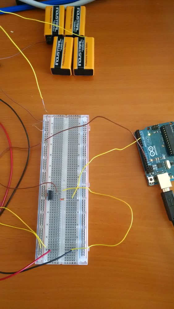

Can you post another picture of your project now thank-you?
I did rewire the circuit as suggested; I actually had it that way originally, but then I thought I got the COLLECTOR and EMITTER pins switched in my head.

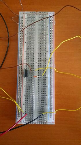

A new picture of your circuit is in order, to double-check connections.
Sure, no problem. I've tried to move the wires to make the connections as clear as possible. Please let me know if the link does not work.

I get 'Access Denied' for your image. It's actually better to post your image here on the forums anyway, instead of on another site.
If you edit your post using >"More" >"Modify", below the text box is an option to add attachments.

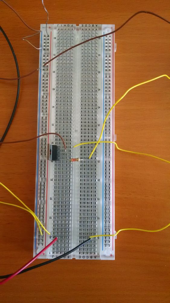

Yeah, I was concerned about that. I will just attach it, hopefully this works now.
Yep, that worked:-
(Right-click and "View Image" or similar for full size.)
Everything looks OK to me.
I assume that the wires going off to the right are to the Arduino, with brown to Arduino ground, and the ones at the top left come from the batteries, with the red and black to the solenoid.
It's looking more and more like a dead transistor, shorted between collector and emitter such that it can't turn off. If you remove the resistor, does the solenoid switch off? (Leave the other wires exactly where thay are.)
Edit: I just noticed that the bare ends of the wires going into the breadboard for the transistor's collector and emitter look like they could be touching. Are they?
(I usually only bare just enough wire to go into the breadboard holes, so no bare wire is exposed outside the breadboard.)

Another picture of your connections to the transistor BC547 would be great also.
Thanks.. Tom. :slight_smile:
A true mystery. The other thing that was in my mind, unlikely as it is, was a short in the breadboard.
Regarding power requirements, the datasheet claims 0.4W with light. At 24V, that's only 17mA. An LED on it's own usually draws 10mA to 20mA. If the LED draws 10mA, that only leaves 7mA for the actual solenoid coil. And solenoids usually use considerably more than that.
Still, quite puzzling. I wonder if it is a problem with the breadboard?
