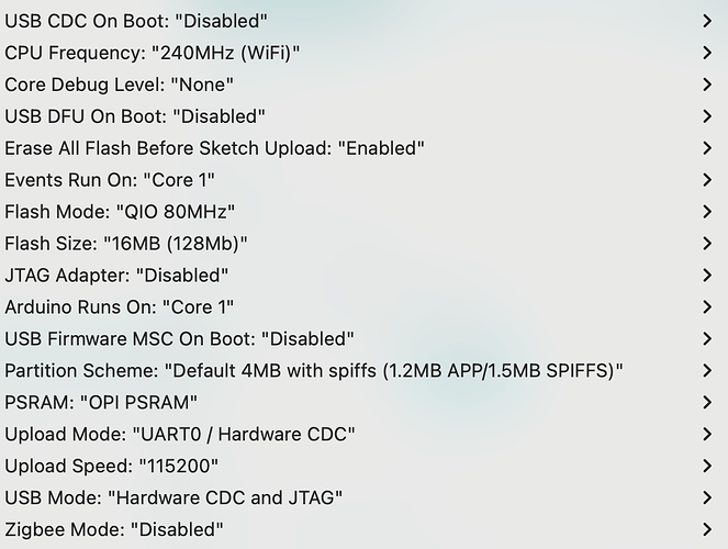

USB and COM port, it is flashed through one, but Serial works through the other in ESP32-S3
I have a Mac with an ARM chip and Arduino IDE 2.3.3, ESP32-S3-N16R8-WROOM-1, but when I try to load via the COM port it gives an error about "target RAM"(A fatal error occurred: Failed to write to target RAM (result was 01070000: Operation timed out)), if I load the script via USB, I won't have work Serial. Also based on the boot data, my 16MB flash and 8MB RAM are not connected, since I have around 1KB available here and there, what should I do?

I don't use ESP32 based boards. But I did find in the past on this forum that for some ESP32 based boards you need to set the below to enabled if you want be able to send / receive serial data to / from a PC. So you can try that.

when programming it using the Arduino IDE I connect to the USB port labeled COM
EDIT: the IDE serial monitor works thru the COM port as well
the USB port labeled USB is for USB OTG applications
Tools>Board I used ESP32S3 Dev Board
You showed me screenshot from Windows, it doesn't have such problems as in Mac where you get this error: A fatal error occurred: Failed to write to target RAM (result was 01070000: Operation timed out)

And problem with flash hasn't been solved, I tried to change Partion sheme to 8M with spiffs(I also have variant of ffat, but I do not know the meaning of Spiffs and ffat), if I choose ESP 16M SR, MCU gives error:
usage: esptool write_flash [-h] [--erase-all] [--flash_freq {keep,80m,60m,48m,40m,30m,26m,24m,20m,16m,15m,12m}] [--flash_mode {keep,qio,qout,dio,dout}] [--flash_size {detect,keep,256KB,512KB,1MB,2MB,2MB-c1,4MB,4MB-c1,8MB,16MB,32MB,64MB,128MB}] [--spi-connection SPI_CONNECTION] [--no-progress] [--verify] [--encrypt] [--encrypt-files <address> <filename> [<address> <filename> ...]] [--ignore-flash-encryption-efuse-setting] [--force] [--compress | --no-compress] <address> <filename> [<address> <filename> ...] esptool write_flash: error: argument <address> <filename>: [Errno 2] No such file or directory: ...
changing my Tools>Board settings to match yours in post 1 as soon as I set Flash Size "16MB (128MB)" the code appears to load OK but crashes when I hit reset

E (88) spi_flash: Detected size(8192k) smaller than the size in the binary image header(16384k). Probe failed.

Flash size 4MB or 8MB loads and runs OK
try changing your flash size setting?
When I have 16 mb in that setting, it doesn’t give any errors, but it doesn’t add space either, I had problems with the Partion sheme. As I understand it (your error is not familiar to me, I have never encountered it) is due to the fact that you have N8R8( (88) spi_flash: Detected size(8192k) smaller than the size in the binary image header( 16384k). Probe failed.), but I have an N16R8 in which these 16 are not used exactly the same as 8MB RAM.

You can program or upload code to those ESP32S3 Dev boards either through the port labeled USB or COM\UART.
The COM\UART port is easier to use, less messing about getting to see the Serial output in the Serial Monitor.

Got a esp32s3 cam, only ever used the uart to upload, never had any issues..
I don't erase all flash before uploading, so you could try disabling that..
A quick google search..
Looks like you are having a driver issue and seems to be affecting mostly macs..
Don't have a mac so won't be much help, sorry..
But if your port shows up as usbmodem, that's probably the issue..
