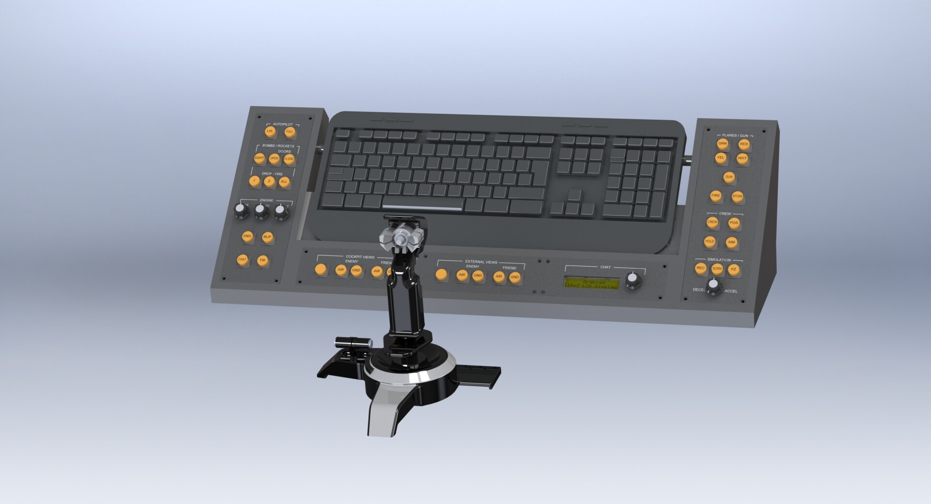

I think I know what you are trying to do. If so, I did a similar project. I like to fly flight simulators/games. One in particular is a WWI flight simulator called Rise of Flight. There are dozens of things to control and each is done with key strokes but it is a clumsy thing to do while trying to fly in the sim.
I designed a console that connects to the computer via USB. Each button, switch, knob, etc. on the panel sends the appropriate keystrokes (or whatever) to the computer.
Is this the kind of project you are trying to do?
