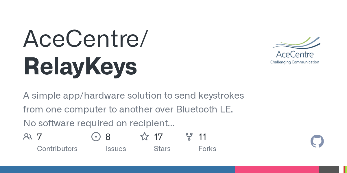

The RelayKeys project implements something similar but I think is designed for Windows. The intended use is for complex communication devices for disabled users. But the Arduino device doing the heavy lifting is relaying USB HID keyboard and mouse from a Win PC to a different device via BLE HID. The target device only needs to support BLE HID so could be Mac, iPhone, Android, etc.
The other important piece is the Mac app that captures raw keyboard and mouse input then writes HID out to the Arduino board.

You might able to use the Arduino source code from the RelayKeys project as-is or as a way to gauge difficulty based on, for example, number of lines of code. The nRF52840 version is only about 1000 lines of code.

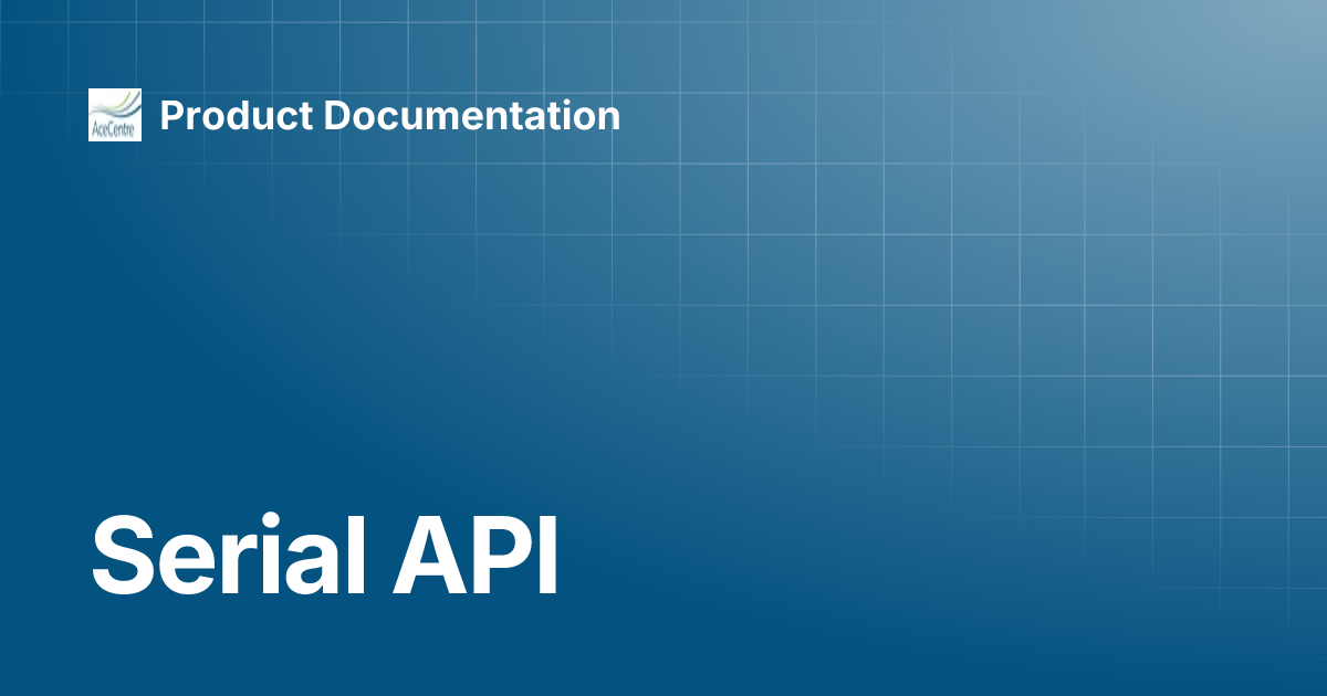

Both Arduino programs implement the following AT command set to control the BLE stack.
Adafruit nRF52840 board version
Hardware: Adafruit nRF52840 Express, ItsyBitsy, or compatible board

This implementation provides the same AT command interface as the nRF52840
version but uses ESP32 BLE libraries and capabilities.
