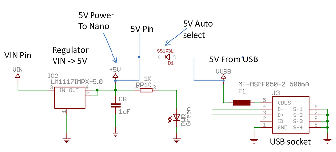

It's okay to have USB connected and power applied to the Vin pin at the same time. I do this with a small project powered from a 9V battery at the Vin pin. I don't have to disconnect the battery when I want to upload or use the serial monitor.
I mashed this diagram together with screen snips from the official Nano schematic and added the blue lines and the black text.
When you have the buck output connected to the 5V pin and have the USB connected, D1 (5V auto select) doesn't conduct. So the 5V power to the Nano comes from the 5V pin. [Edit: The same reasoning applies to having power connected to Vin pin and USB connected]
It's not okay to have a power supply connected to the Vin pin, and another connected to the 5V pin at the same time.
