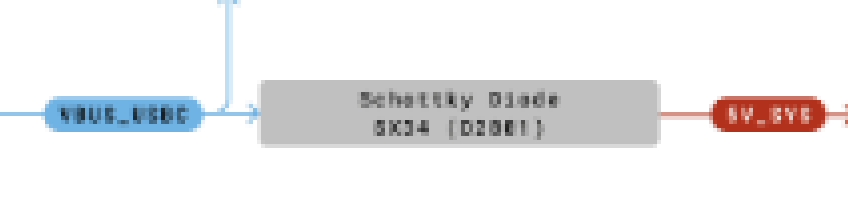

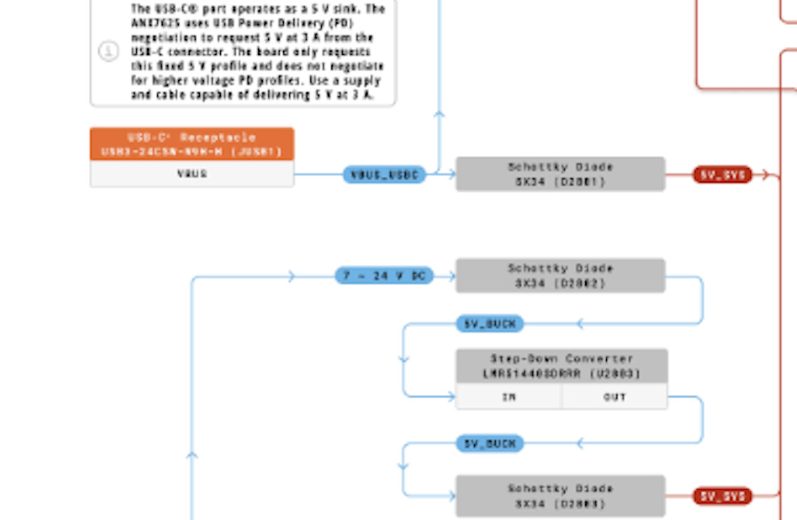

That makes no sense. The VIN powers everything, it's the Schotky diode that prevents back feeding.
Have you looked at the power tree for the board?
I don't understand your point.
One of us is very confused. How could powering the board externally have anything to do with a USB-HUB.
Again, have you looked at the power tree, there is no path back to the USB port.
Here is the part of the entire power tree that shows the blocking diode.
Here is a larger look at the USB part of the power tree. Remember, this is USB-C PD! The PD part is requesting the USB power supply to provide 5V at 3A.
Notice the Schottky diodes.

I checked the Power specifications, in particular the USB-C VBUS Back-Drive section.
As I suspected, there is a P-channel MOSFET (Q2801) to power the USB 5V rail when the board is in host mode.
I was thinking the problem was that the board wasn’t switching to host mode, which prevented the power rail from activating, but it seems more of a symptom than the cause.
Could it be that the MOSFET isn't being enabled?
This would explain the lack of output power on the USB and the board not switching to host, since it’s not seeing anything to be the host of.
